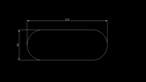

    There's a channel routed into the drawer/cupboard surface measuring 106mm long X 40mm wide.
    Whatever happens, I don't want to be routing out a bigger hole. I have found similar & very,very close, but nothing that will cover these holes.

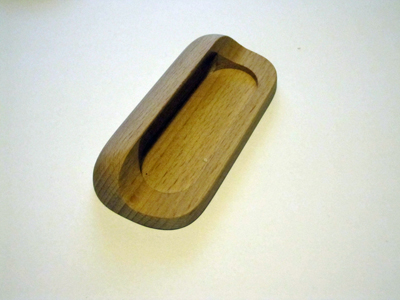

    Picked up one of these today from one of the DIY sheds : £4.99 ea 'BARGAIN'. Sad thing is I've tracked down the importer from the label & they're only 5mls away from me. One quick phone call & they refuse to supply anyone not bona fide kitchen manu' or massive rip off DIY retail shed chain.
    It's not recessed so it would have to be surface mounted. There's 2x screw holes on the back, so I'd have to simply drill 2x holes in the draw & cabinet fronts & screw in from the back. It's totally unfinished & if it weren't from China I'd say it was Beech. Do they have Beech in China?
    It's 115mm long X 50mm wide. At it's deepest it is 20mm. It looks to be made using 4 diff tools on 4 operations, the last of which would be the recess for the fingers which would also involve rotating the part.
    I'm not fixated on this design, anything will do as long as it's aesthetically pleasing to the eye & it uses or hides the existing holes.

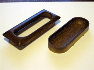

    This rare beast is the last in the world of the original plastic handles.

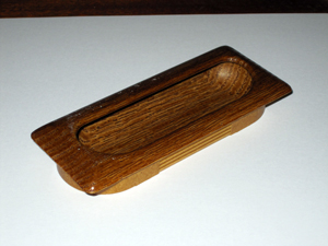

    Easily splits into 2x parts. It's the lip that the fingers grip which is failing. It fractures at one end then quickly splits along the grain.
