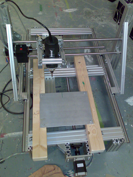

    Current CNC mill is undergoing reconstruction after learning via trial and error that unsupported rails are pretty wonky, and that I could have used rubber bands for similar accuracy. Alu frame could do with cross bracing as well as possibly reducing the size. Cut a few parts, but have a few accuracy errors in my standalone custom CPU stepper driver to fix before doing some serious work.

    Welcome to the forums steve, i'm also hoping to build an ali frame cnc like yours some time this "<" side of christmas.
    Where did you buy your framing from ?, how do you find the Trend Unit overall ?

    Hi Lee,
    The framing is FlexLink XD structural aluminium from RS components. It's a little pricey, certainly the t-slot nuts and angle brackets aren't cheap, but it's convenient for me as RS are just down the road. All held together by M5 hex bolts.
    The Trend T3 router which I got from Rutlands.co.uk is a handy size and weight, pretty powerful and multispeed. My only complaint is being limited to 6mm, 6.35mm and 8mm collets, of which I've lost the 6mm collet and cannot find a cheap replacement. So that limits the selection of mills I can use quite drastically. I was going to add a rev-counter to it so I can accurately measure speed, but that's on hold at the moment.
    I have an ER20 collet set and chuck which I intend to make a cnc mount for, and either use the router to power it via belt or get some other high power motor or servo linked up to it. So I'll be documenting that as I go along.
    Well it’s a good job you came to the right place then, I have got some 1/4" to 1/8" collets coming from the USA. As luck would have it if you’re interested I have not ordered them yet, they are about £10 each and designed to fit our kind or spindles.
    I’ve got a Ferm FBF-6E, from what I can see and what the internet suggests the Trend T3 units are basically a re-badged version of the Ferm.
    Now if you look on eBay you will see the Trend T3 up for £55 or something very close to that. Now this Ferm unit cost me £10 + £8 postage, tonight I have just found another seller who has also done me the same deal, this time I paid £15 all in.
    Fair enough these units are both second hand but as luck would have it both have not really had much use according to the sellers, what I’m getting at is they seem to be a good price if you’re willing to look for them. The Ferm FBF-6E ok it’s an older (3 years?) unit but all I have done is re-greased the bearings, the bushings are still well over half left on them.
    I’ve not checked but I’m guessing the bearings are the 608ZZ type so easy to source and replace.
    The sellers seem to be listing these units on auctions rather than "Buy it Now" on eBay, all I did was email them offering £10 paid via PayPal and I would take care of DHL collecting them. Maybe I got lucky twice :), I have seen a number of these units going over eBay for the last few weeks now, I’ve just also been sold a Trend T3 tonight for £20, same situation again.
    If your reading this and about to buy a Trend T3 Unit for your machine, take some time first and look for the Ferm unit, if they are not on a "Buy It Now" in your price range, email the seller you never know what you can pick up, takes 2min's to email the seller ! And as tonight shows you could do the same and possibly get yourself a T3 cheap.

    What one did you order skit? I also noted that one of the Kress collets would also fit but im not sure how well it would work.

    Still tempted to replace the T3 with a lightweight brushless motor though, I notice RC motors are getting quite powerful and performance tight. Seems like a fair amount of research to do before going down that route though.
    I had the same results steve with google, you maybe better off going for an AC motor and inverter over DC as they are low voltage and high current.
    They are a bit bulky but cheap and you can control the speed easy, use a small AC three phase motor and an inverter for £250 and you now have a 1KW varible speed spindle.
    If you use a DC motor you will need aditional electronics to control the speed and high current dc drives are not that cheap. All depends what you want really.
