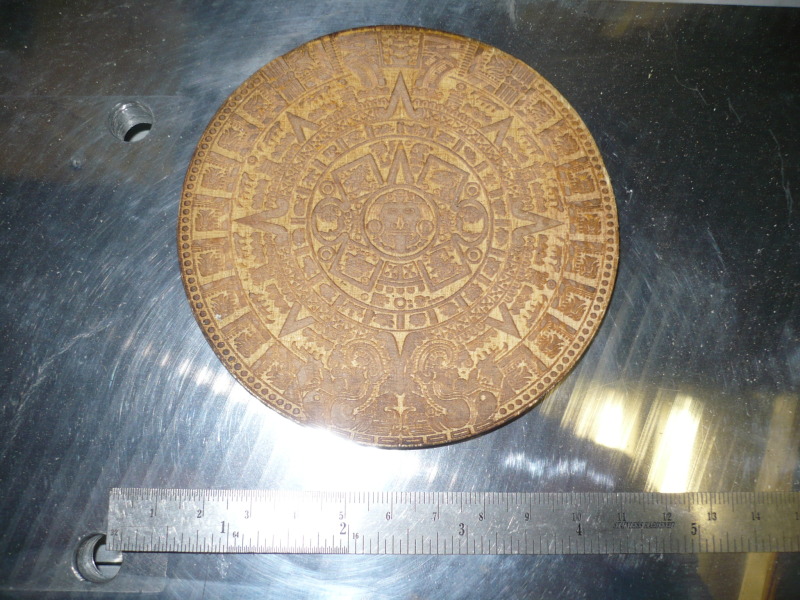

    I expect to see your mayan calender on Monday...
    Sunday any good ?
    Been kicking about for a while and it's lost some of it's detail. Should have sealed it but didn't bother as it was just part of the packing case the laser came in.
    About 4" diameter and took 7 minutes.
