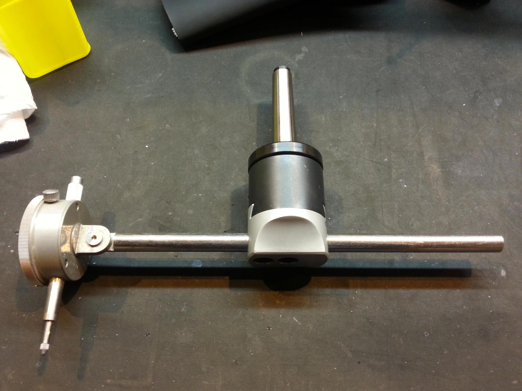

    If you have a boring head all you need is a bar to fit the clock guage to. Works well and is adjustable for length. I cant upload a photo from my phone but will post one later.
  6. #16
    Photo as promised.
    Easily adjustable for the length or width of your bed.
