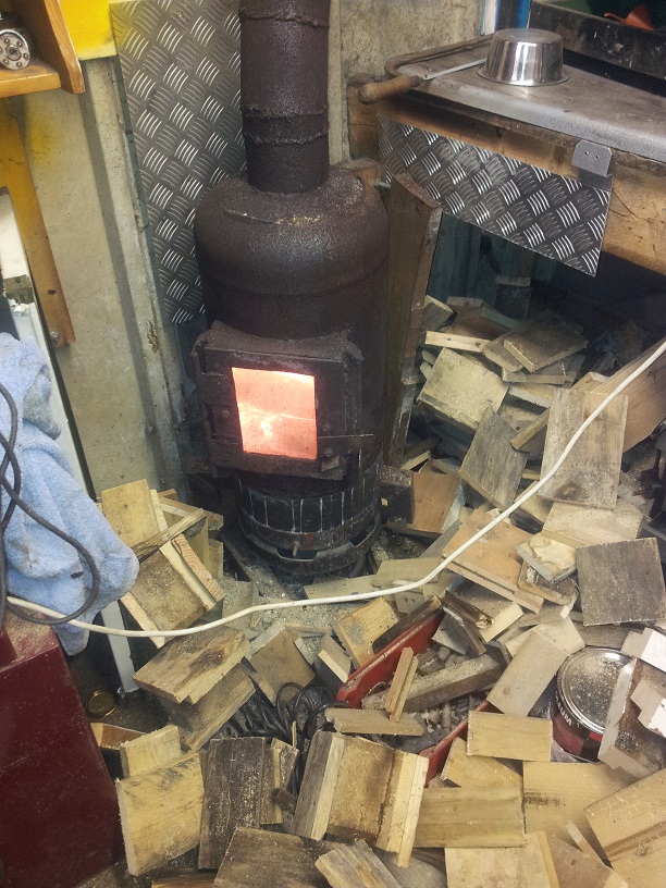

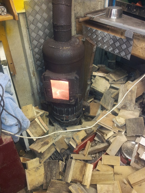

    I also share with a freezer; and a computer (which I leave on all the time) - even when I had the drippy metal roof (before I added ocb & felt) the computer was fine... but just leave it on and it generates enough temperature to look after itself.
    now, with the new roof its nice and dry in there even in the worst weather we've had... I can tell this because the saw dust remains saw-dust!!! :-D Dont know why I didnt do it sooner think it only cost £200 notes all in?
    Also made a log-burner... to inspire me to get down there after work on these miserable winter nights...

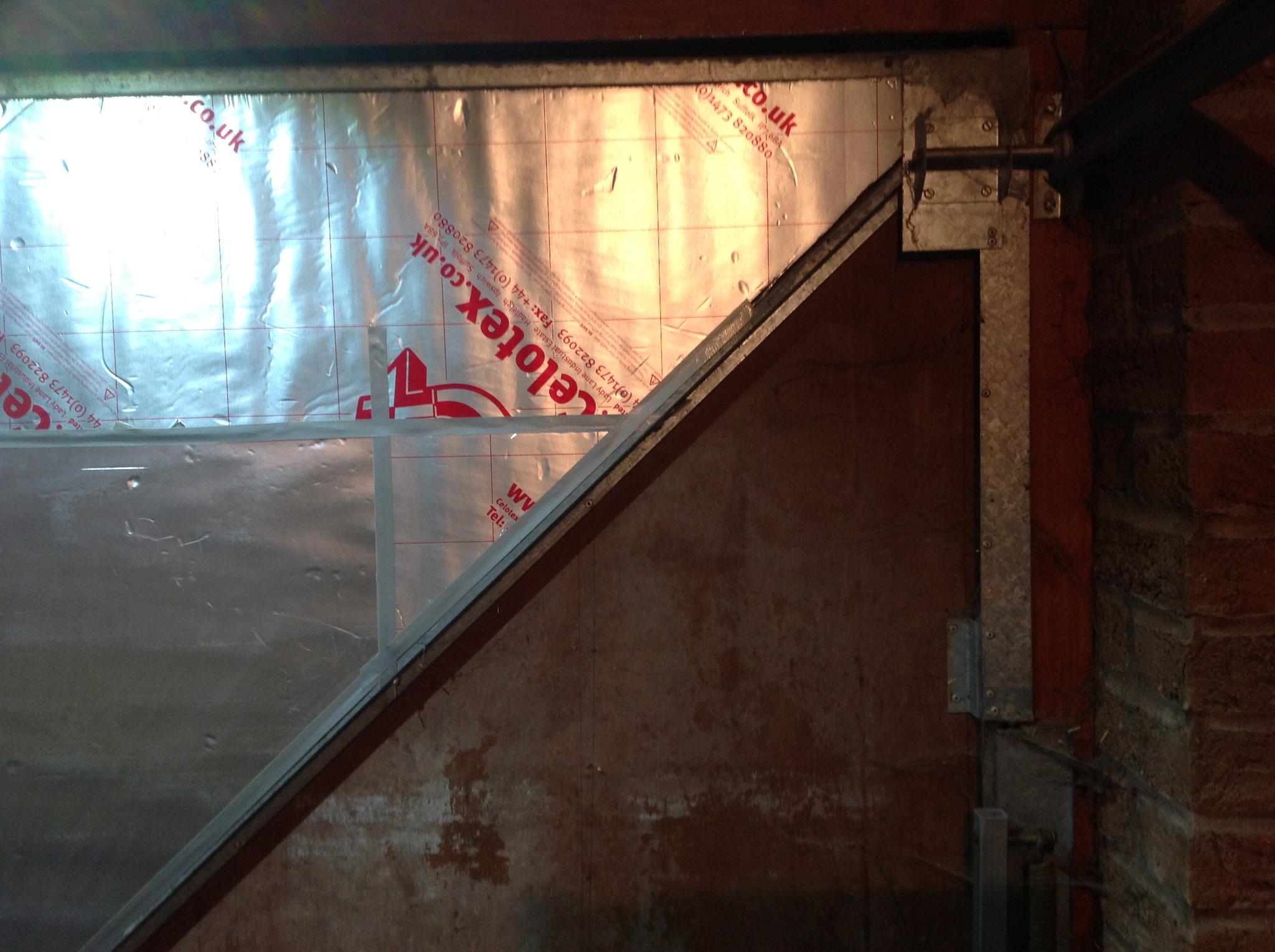

    I got a few sheets of 20mm thick celotex and tried putting it between the rafters. Bloody frustrating that the beams holding the tiles aren't very parallel, or spaced evenly apart. Took the best part of 2 hours to get one "run" in, and the gaps were too big. The joists holding the tiles up are only 7cm deep, so perhaps I should just staple larger/thicker 100mm sheets underneath these and forget doing anything between the joists, leaving a big ventilation gap.
    ... So I had a go at putting some of the 20mm board in the gaps on the back of one of the up-and-over doors, which seems to have gone pretty well so far. The doors are thin ply stapled to a metal frame, so pretty thin wood as-is, but less conductive than metal for sure even with nothing added.

    Ahh, just only wish I could - the rigid insulation boarding is expensive no ?
    Wondering if this place is any good ? Seems way cheaper, but there's no foil on the boards. Is that important ?

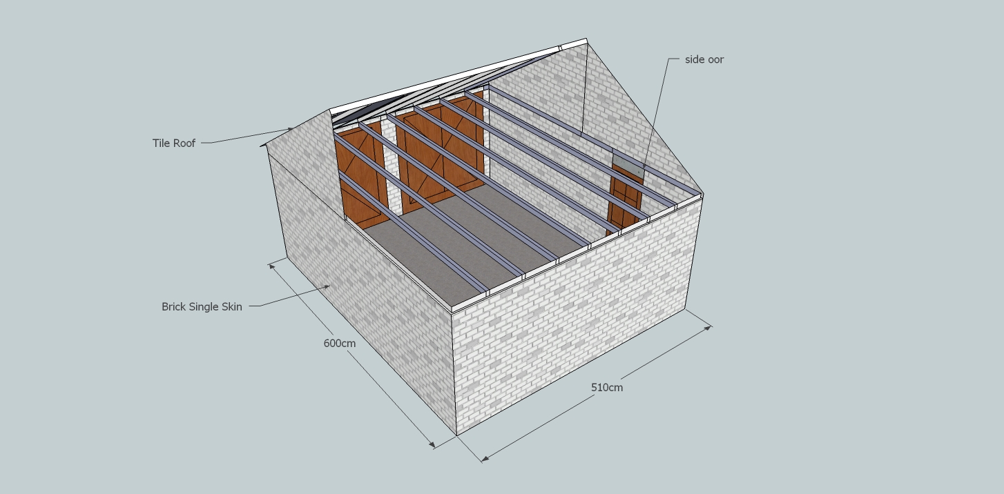

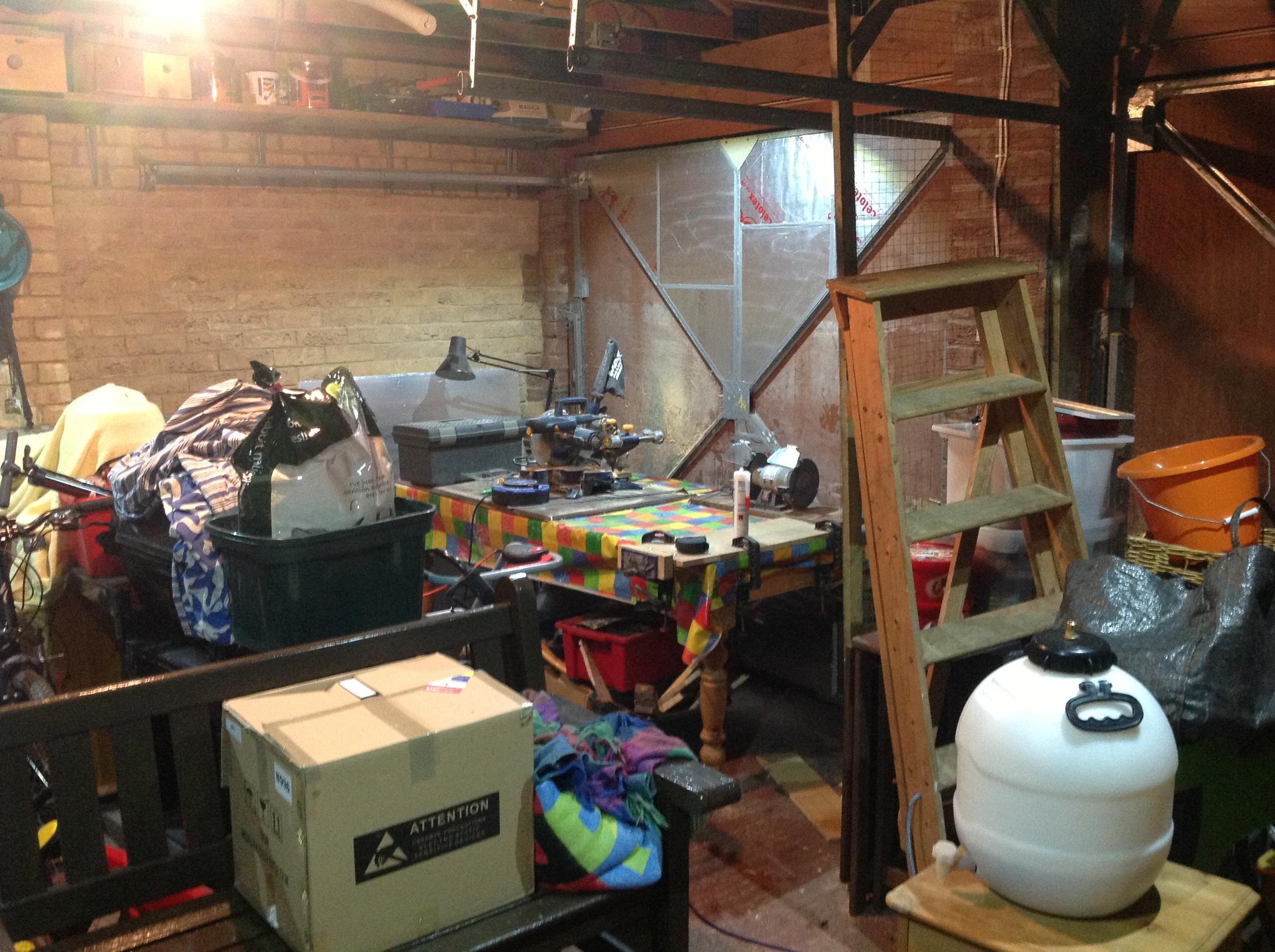

    Initial foray into sketch-up seems to be pretty quick for sketching something. Witness my feeble attempt (attached), but it gives the basic picture I think. Excuse the mess, a spring clean is overdue... in the spring.

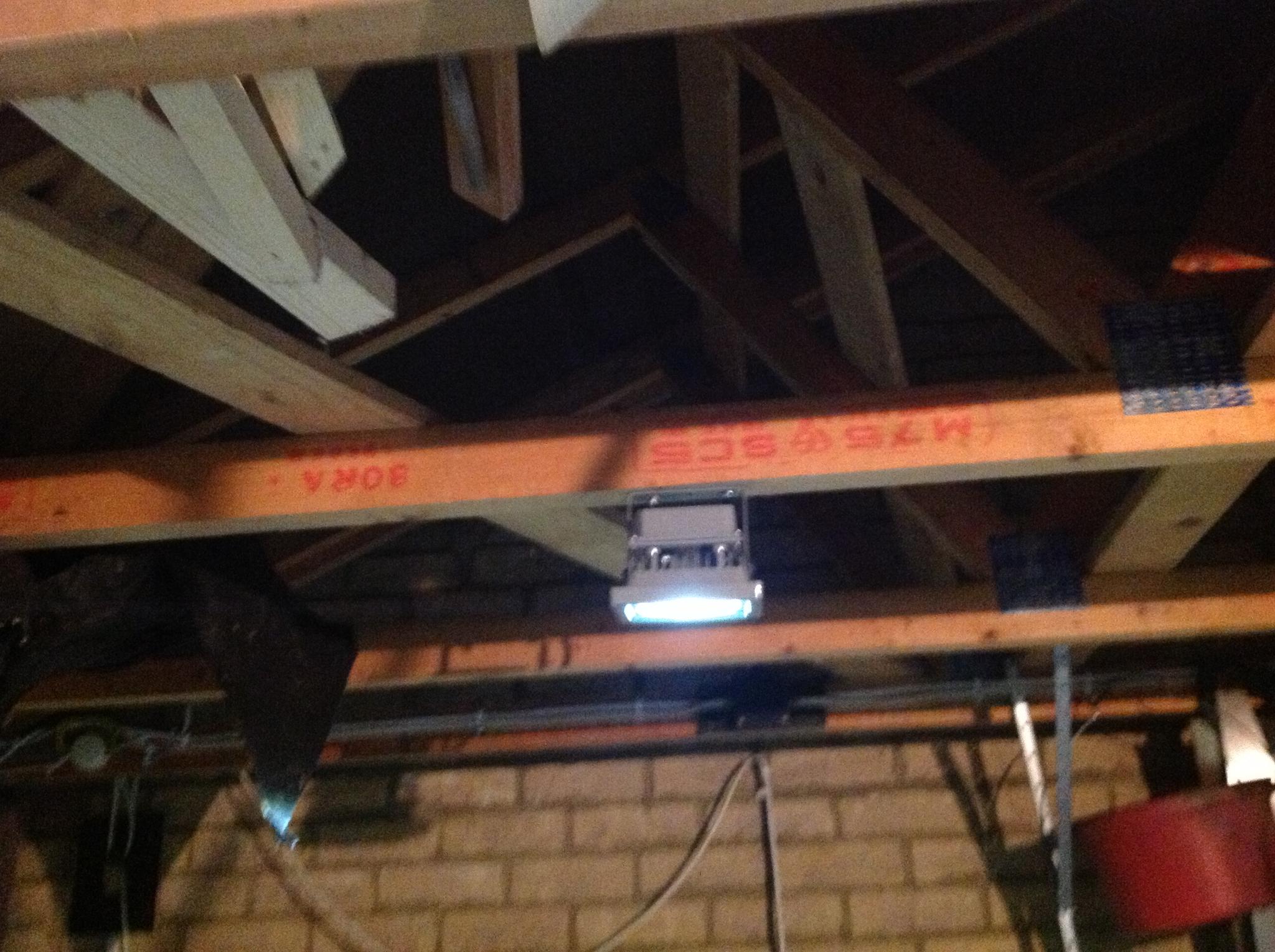

    There are 4 x 10W LED floodlights (80W equivalents each) fitted a few weeks back from LED Hut. Amazing to be able to see things clearly in there at last.

    my god! your one of the lucky ones! There are loads of people out there that would chop their left leg off for a place half the size of that... people who use garden sheds, people who use bedrooms, under the stairs cupboards.. ive seen it all. You genuinely are very lucky
    Atleast its brick!. an d its got an apex roof... its massive!
    sounds to me; like your on the right track. Persevere with packing the drafts and get a small economical small heater that can be left on all the time... it will soon warm up.
