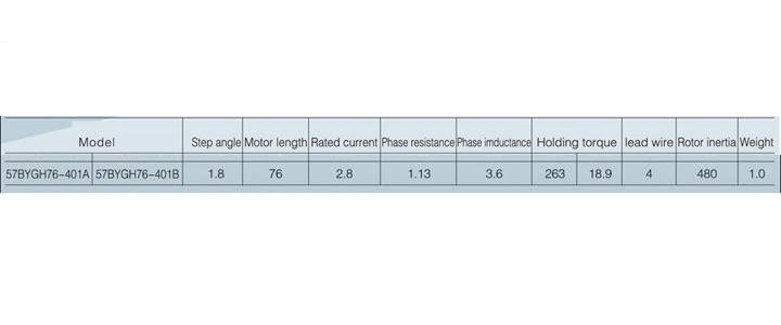

    can you run your eye over this for me jonathan :)
    my motor spec
    new drivers
    i assumed id be setting peak for 2.84 (closest?)
    am i going to smoke anything?
    Setting to 2.84A as you can't get 2.8A is only 3% more heat, which is negligible so you'll be fine. It's always a good idea to keep an eye on the motor temperature to start with just to be sure.
