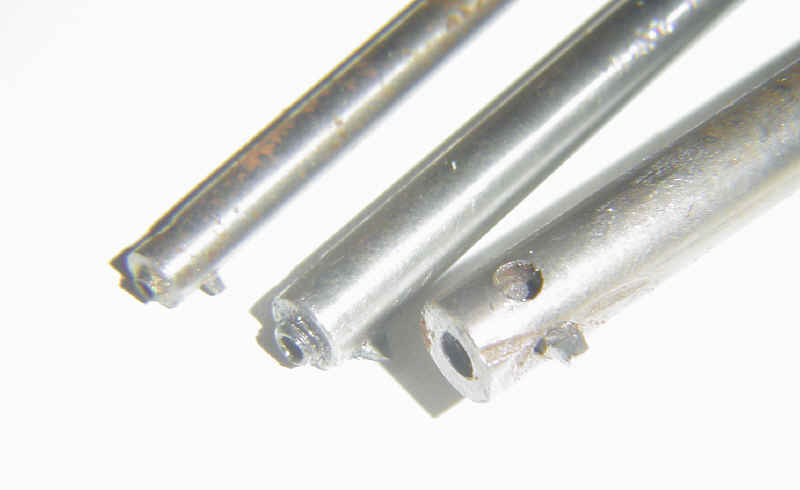

  6. The great advantage of boring in the lathe is getting the OD and ID concentric.
    Why not make a boring bar? The picture of the ones attached are simple steel rods with a cross hole, to take the cutting tool, and a threaded axial hole to fix it. The cutting tools are ground from broken reduced shank carbide PCB bits.
    The smallest one shown here is 5mm Diameter, used to cut the 2" deep, 5/16" ID, LH acme thread for my steady rest support arms.

  7. Yes, you need one like this 5mm head on a 6mm shank (top one on page). If your normal lathe tool is bigger than 6mm then you might want to make up a boring bar holder (or buy one) to hold the cutting edge at the right height.
    Boring is not as accurate as reaming, but within 0.05mm is possible with care and light cuts and thats easily good enough for this need.
