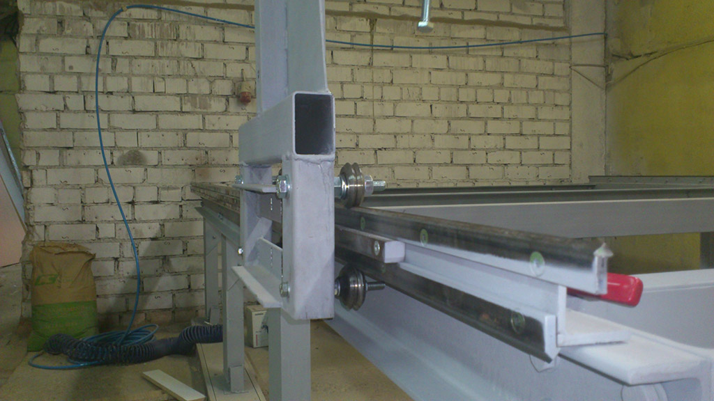

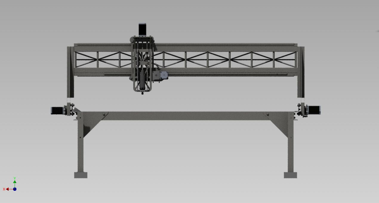

    I have started one year ago cnc project and would like to share it here :) Motors are Nema34 from China, Drivers also from the same place. Linear rails are V groove bearings, got the rails a little used but in good working condition. Also created 3:1 belt reduction with HTD 3M timing belts. Drive system is rack and pinion, module 1.5, accuracy i have at this moment is about 0.2mm.

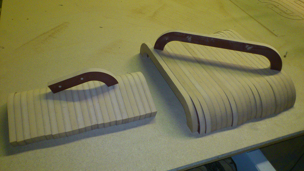

    The first job with my cnc was dust Cyclone, works perfect.

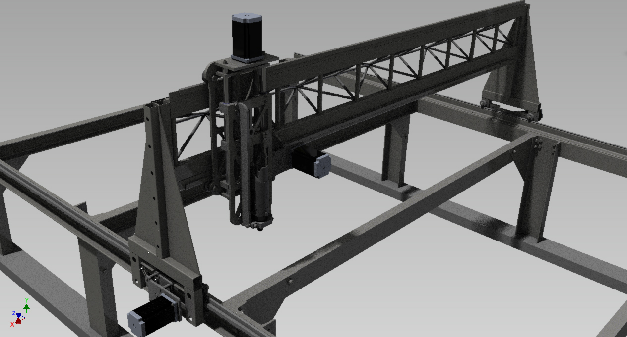

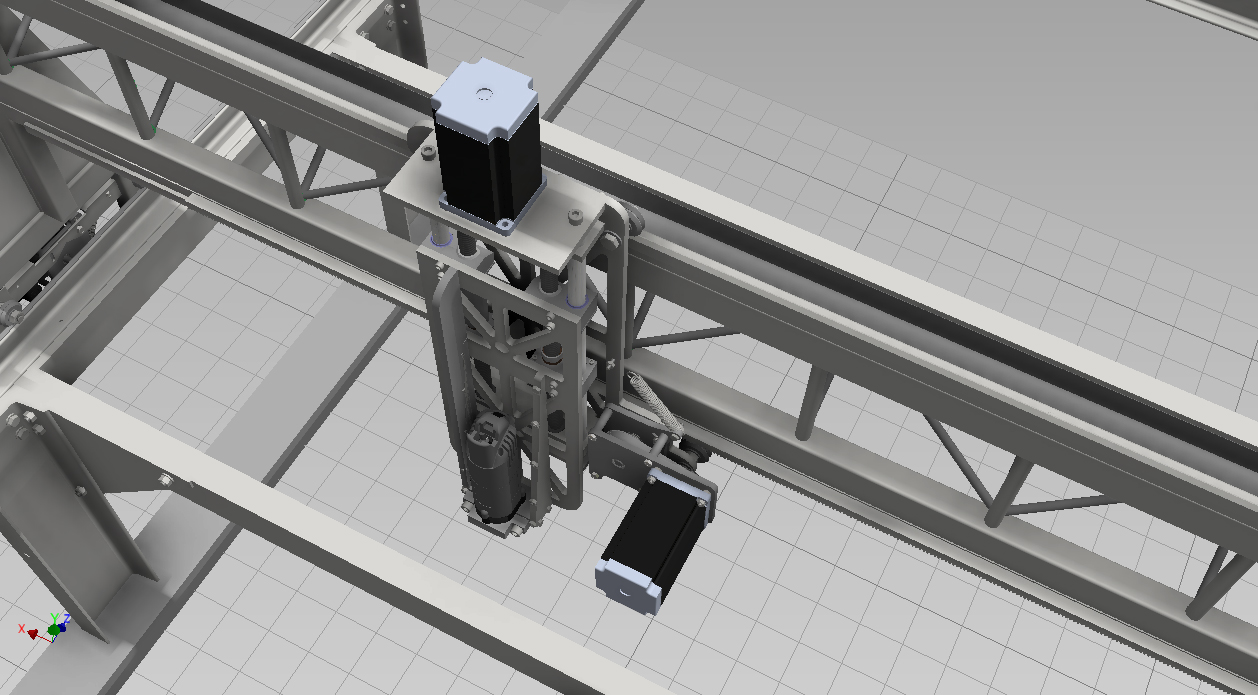

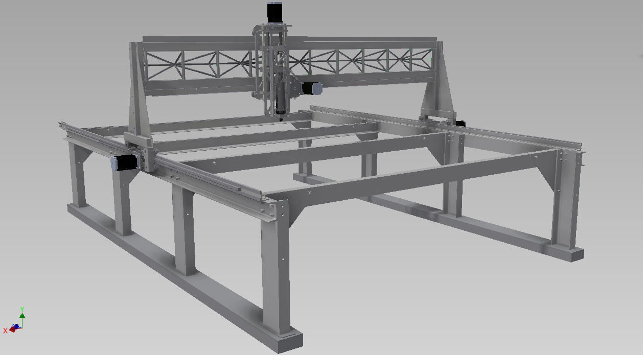

    Attaching some pictures from Inventor:
ID:	8244Click image for larger version.
ID:	8245Click image for larger version.
ID:	8246Click image for larger version.

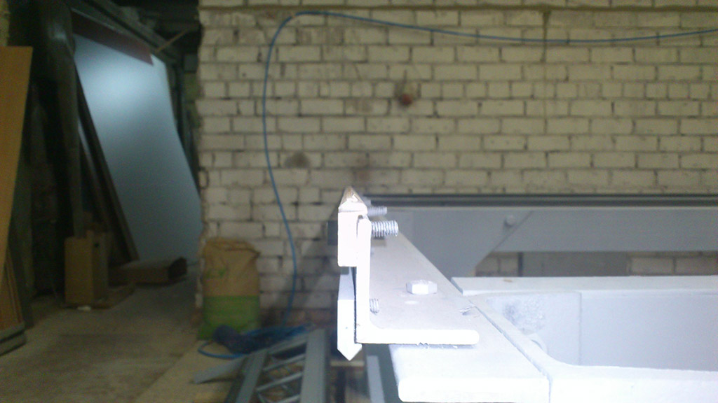

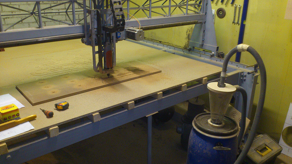

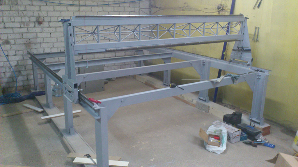

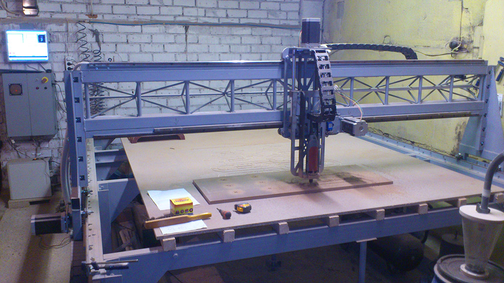

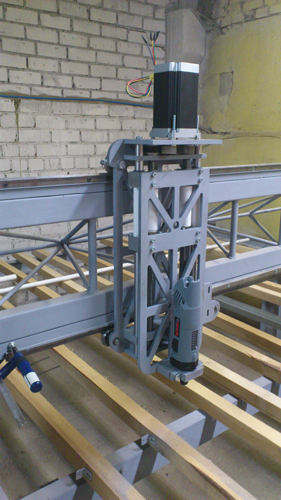

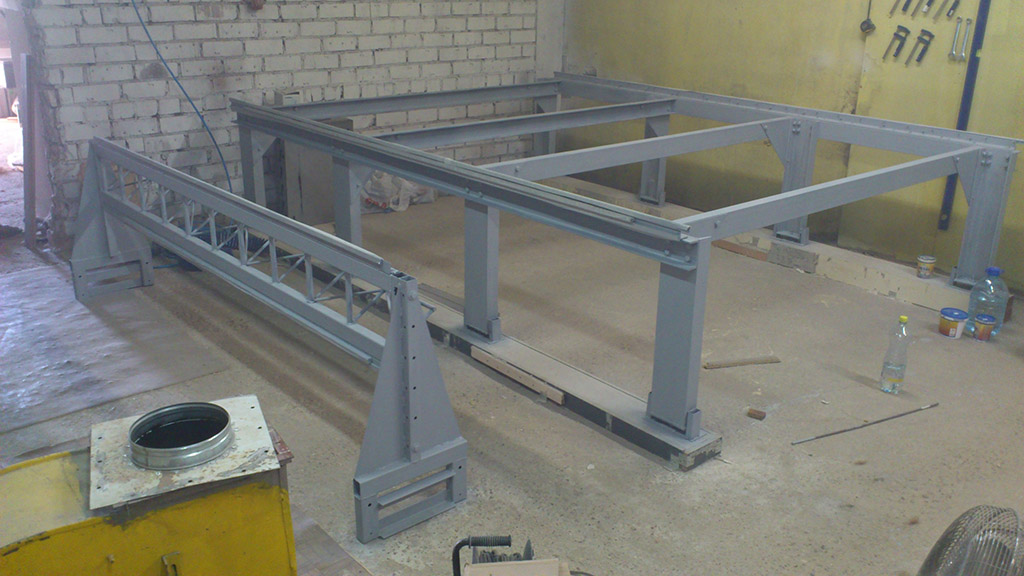

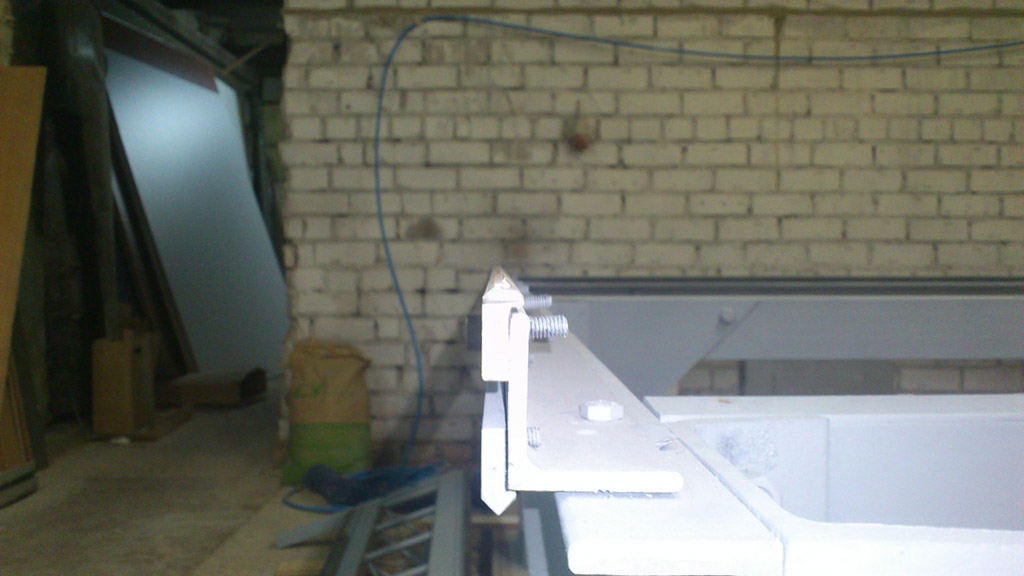

    And here is result after 10 month :)
ID:	8248Click image for larger version.
ID:	8249Click image for larger version.
ID:	8253Click image for larger version.
ID:	8252Click image for larger version.
ID:	8251Click image for larger version.
ID:	8250Click image for larger version.

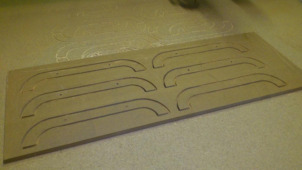

    And here is second cut after dust Cyclone:
ID:	8255Click image for larger version.
    After these i got my Kress router broken. And the warranty ended 1 month ago :) So i have started at Indiegogo new Campaign to help me, to buy new spindle 3-4kw air cooled from China, because these kress routers are not so powerful to cut MDF and wood at high speeds.

    D.C.'s Avatar
    How is the truss gantry working out for you, any problems?
    PS Don't worry about the other comments, they are joking. That said I'm also taking donations if anyone is offering, I recommend a minimum donation of £1000 per month sent straight to my paypal account if you want to guarantee eternal happiness in the afterlife. For £500 excluding shipping I also offer 25mls vials of miraculous healing water personally blessed by me over a magical crystal.
    viz's Avatar
    Lives in Kaunas, Lithuania. Last Activity: 23-08-2013 Has been a member for 9-10 years. Has a total post count of 6.
    I put the glass with water on the table when it was milling MDF and it was difficult to see any vibrations in water. Almost no vibrations at all. Just was complicated to make rails straight, next time if i'll make any new cnc, the table will be different :)
