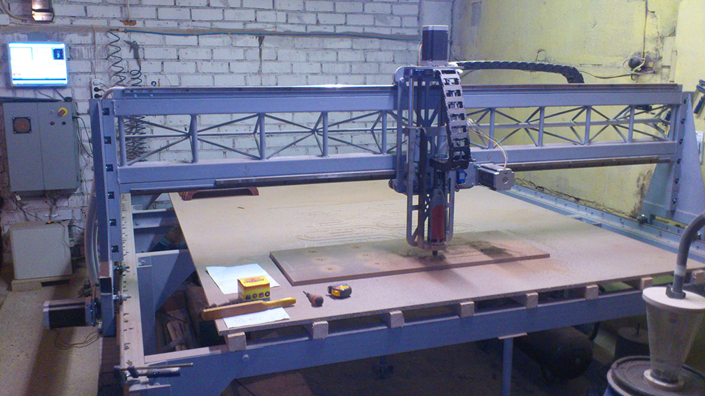

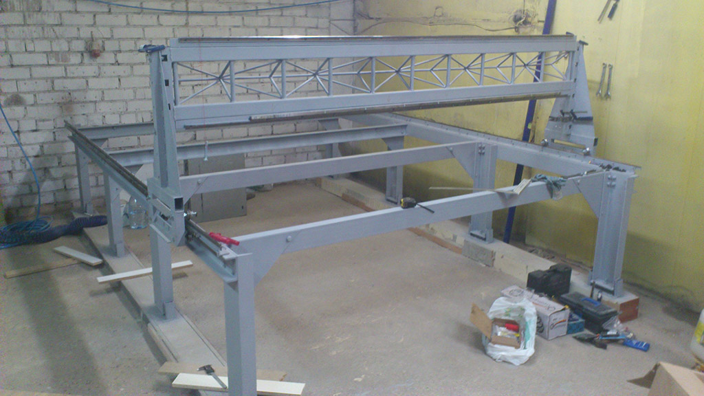

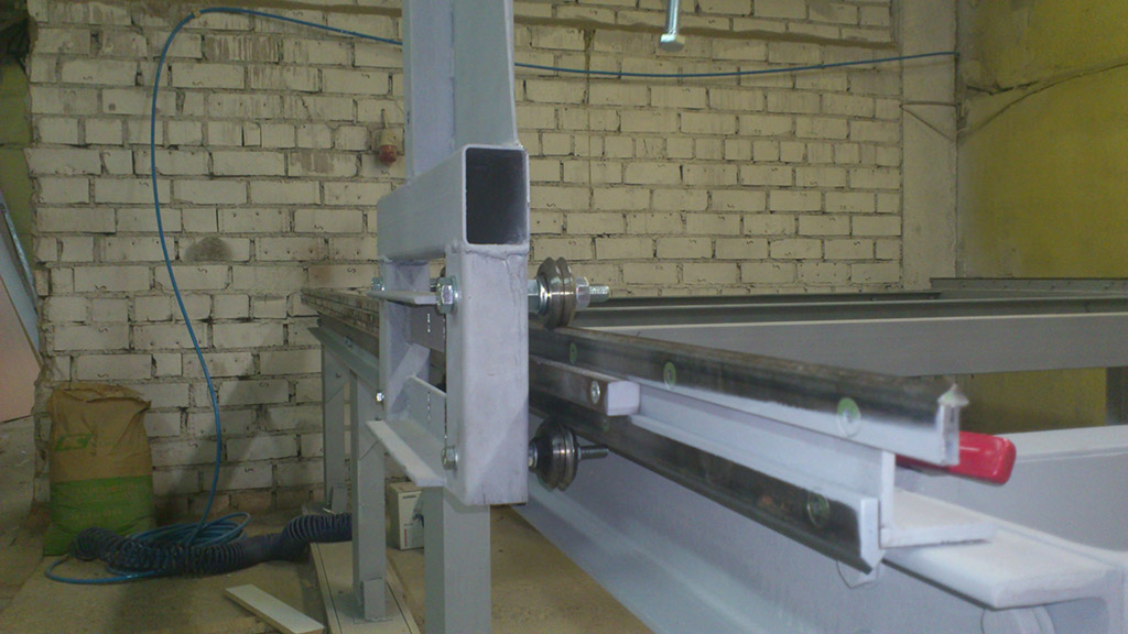

Hello,
I have started one year ago cnc project and would like to share it here :) Motors are Nema34 from China, Drivers also from the same place. Linear rails are V groove bearings, got the rails a little used but in good working condition. Also created 3:1 belt reduction with HTD 3M timing belts. Drive system is rack and pinion, module 1.5, accuracy i have at this moment is about 0.2mm.
The first job with my cnc was dust Cyclone, works perfect.
Attaching some pictures from Inventor:

And here is result after 10 month :)

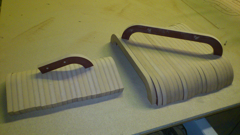

And here is second cut after dust Cyclone:
ID:	8255Click image for larger version.
After these i got my Kress router broken. And the warranty ended 1 month ago :) So i have started at Indiegogo new Campaign to help me, to buy new spindle 3-4kw air cooled from China, because these kress routers are not so powerful to cut MDF and wood at high speeds.
