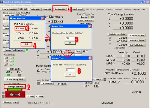

    Just a quick update:
    I just found the "auto setup" thing i asked for above, its under the "Setting Alt6" tab, then look to the bottom left just above the big red "Reset" button. I will post back later today as per my above post.
