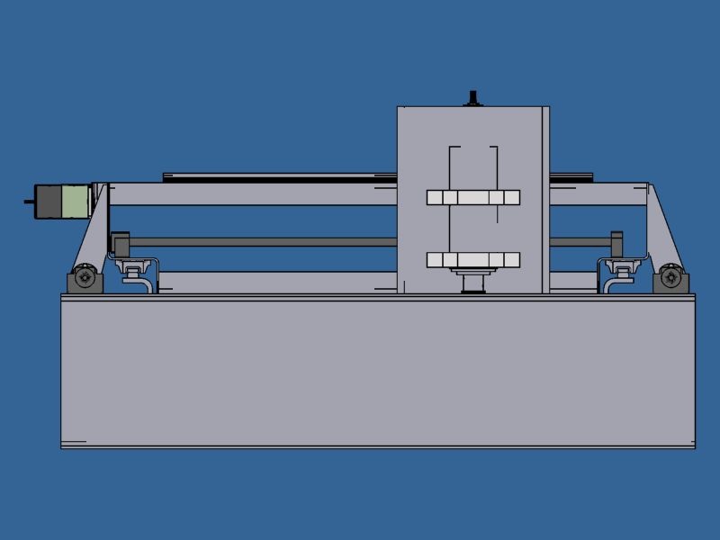

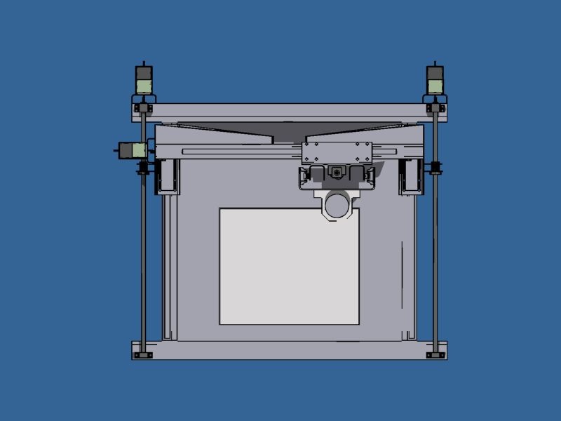

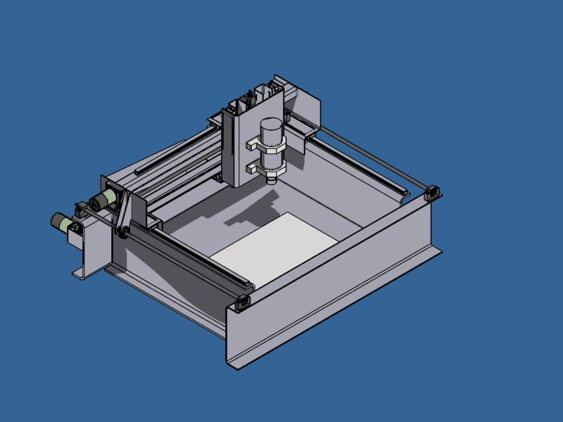

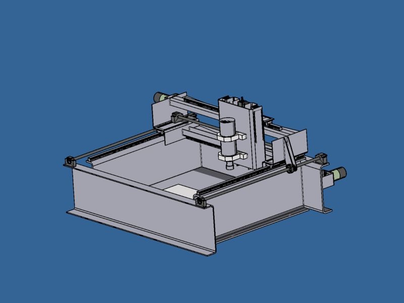

    i want to start a build log for my first DIY cnc machine.
    the construction will be all formed steel welded together.
    1/4 plate for the table and 3/16 plate for the gantry. There are still quit a few gussets I will be adding I just wanted the start this log in case I'm way off.
    3/8 plate for the main bed and bolted on 3/4 aluminum plate for the cutting area bed.
    The reason for the formed steel construction is I can build the whole thing from scrapes at work and not pay for the steel. and I can cnc plasma cut all the parts
    the cutting area will be roughly 15" x 15" x 5".
    all rails will be 20mm profile
    X and Y ball screws will be 1610 with 2.1 pulleys
    Z ball screw will be 1605 with 2.1 pulleys
    i have Nema 23 motors drawn but not sure if there big enough (one of the questions for you guys).
    i want to cut aluminum and stone mostly but I imagine I will cut some hard woods as well.
    questions:
    How does the design look so far? Will this cut aluminum or am I dreaming!!
    Will the Nema 23s be strong enough?
    are the pulleys a good idea or should I direct couple them?
    what step angle (degrees) is recommended?
    i know I will have a lot more questions along the way so thanks I advance for any help.
