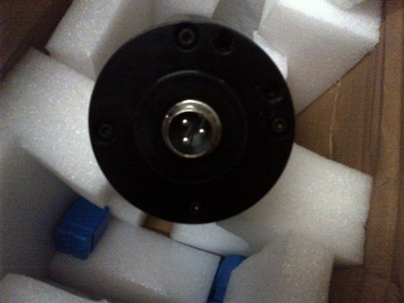

    Quote Originally Posted by andrewuk View Post
    The spindles from Portsmouth are the 3 pin type, I don't know if that means anything.I have to say delivery was fast and it was well packaged,I paid £218.00 from lovehappyshopping.
    I received mine a few weeks ago from industry-village and it has a silver end cap where the connector goes and its got 4 pins.
  2. #122
    Quote Originally Posted by Gotty101 View Post
    Some have 3 some have 4 but only 3 of the 4 pins are used the 4th pin is unconnected to anything. Some use it for an earth.!

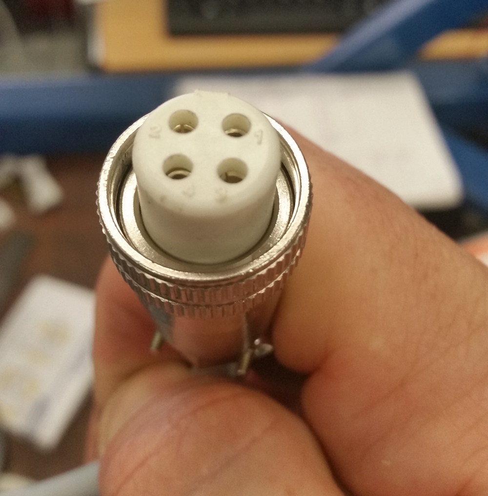

    Just wired my spindle and VFD and followed the diagram in post 1 and it kept tripping.......that was because the pin numbers were different.....
    Had to cut and re-wire the VFD end as the spindle end is soldered.......still it works now so all good. Just have a look on your connector if you've got the 4 pin variant that's all
    Neil...
    Build log...here
  9. #129
    I recommend checking with a multimeter what the resistance it between each of the pins, as who knows if the companies making these spindles are consistent. You should get a couple of ohms between the motor terminals and zero ohms to the spindle body, or high impedance when they don't bother with the earth.
