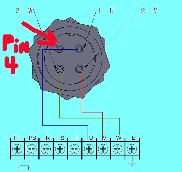

    Spindle end wiring diagram:
    (Pins are numerically marked on the inside of the plug, check by taking the 3 hex bolts out the spindle top cap. Whilst your in there take a ground from pin 4 to one of the 3 bolts inside that holds the bearing cap)

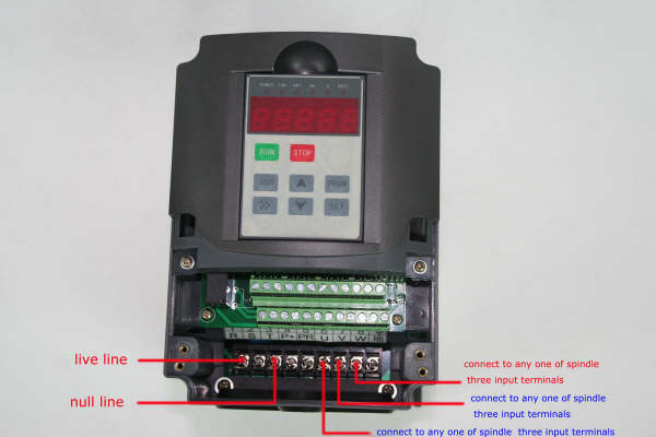

    VFD end wiring diagram:
    Live = R, Neutral = T, Earth = E.
