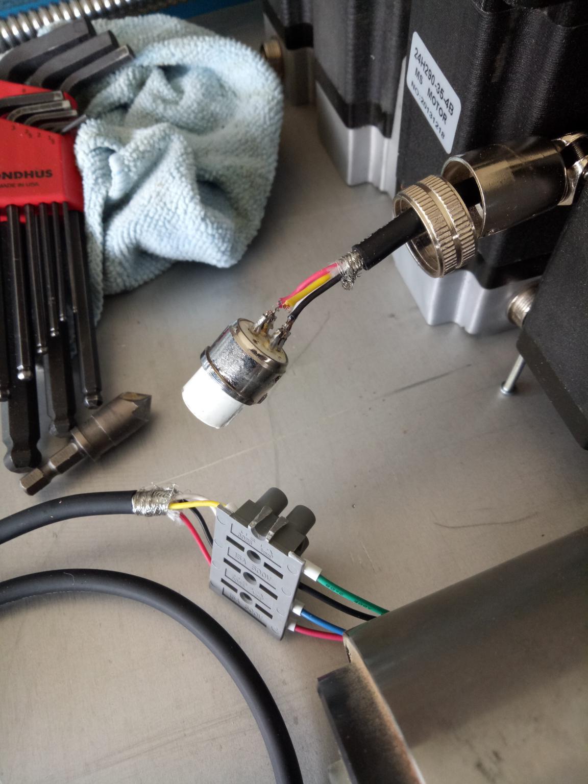

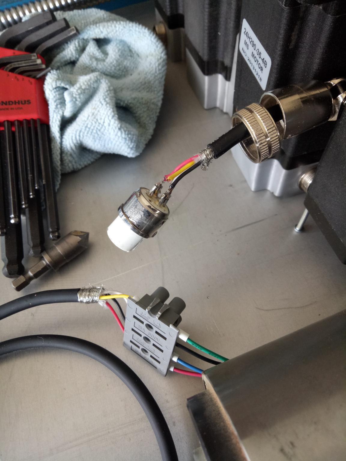

  5. #173
    Another thing to remember is to use the correct cable between the drive and motor. I just repaired a machine where the original builder used microphone cable (2.2 Kw Hy water cooled spindle)...besides the fact it's not rated for the voltage imagine the under size re current!!! If you can't confirm the voltage rating of the cable then just don't use it :)

  7. #174
    Happened to document it....note also the soldering Click image for larger version.
