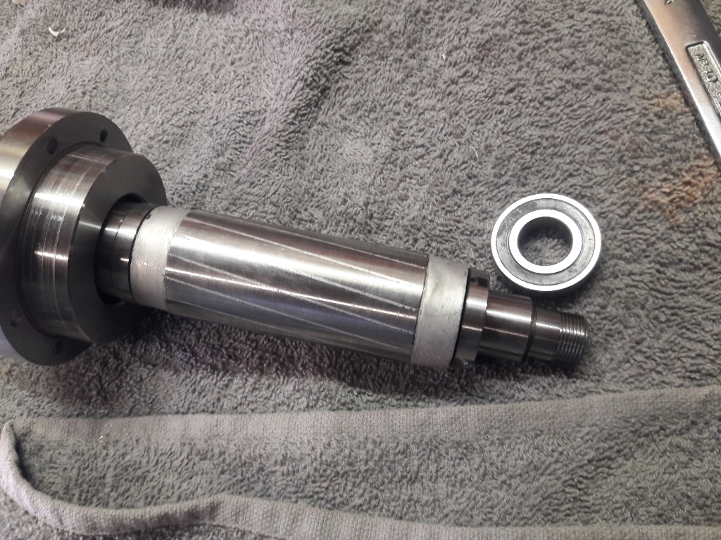

    Thank you all for your involvement, the fact that it's one of the bigger seller disappointed me. I had a very good experience with the BST Automation after sale service and thought it will be the same... Thanks again. News from my old friend, just one sentence: "The sound of grease".

    Some news: solded as a 4 bearings unit, well well well.

    Just listened to the video and I have heard people talk about the settling of grease in bearings (clough42 channel where he showed a very nice spindle with PDB made in the US that had a small amount of chatter). So my own view is that it can be a cause but this sounds too loud.
    My bet would be the bearings are skipping around as the noise is quite loud. Are the bearings a press or good fit on the spindle shaft and housing? Wonder if they are machined out of spec?
    Do you have tools to measure the fits ?
    If the bearings spin nicely in your hand try loctiting them place if you are looking to try and repair it yourself.
  10. #220
    I've been looking for the difinitive "How to dissassemble, re-grease and reassemble your 2.2Kw water cooled spindle without breaking it" thread but haven't found it. I'm sure a list of key pointers to what you must and must not do and what tools you must have before you begin would be much appreciated by many readers contemplating a check of their bearings. Is this something the pro users do regularly?
