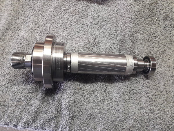

    Spindle: 1 Me: 0
    It's a pita because you must fabricate your tools, and even they easily breaks (only 2.5mm pins...). You must heat at least 3 minutes in full power with your heater before trying unscrew this "#&@% full of holes". I enlarged them to 5mm,. But after this first victory, there's another flange. End of the story for me.

    The 6002 bearing must have the large side pointed to the top. It's not a radial bearing.
