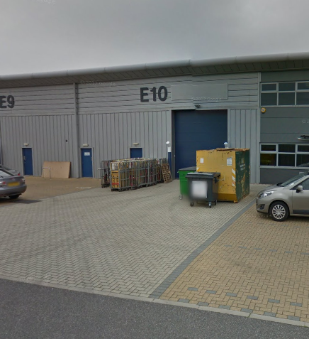

    as far as I can tell, the majority of the ones on 'ebay uk' that boast UK shipping, are, UK shippers.
    Personally I think although there are 20 different 'seller accounts' selling them, they are all in portsmouth.
    Now I am returning them... I have an actual address. which resolves to a generic unbranded unit

    to be fair, they deliver next day, well packaged and have always been good at sorting any problems out
    maybe a touch more expensive than the UK
    I used 'love-happyshopping'
