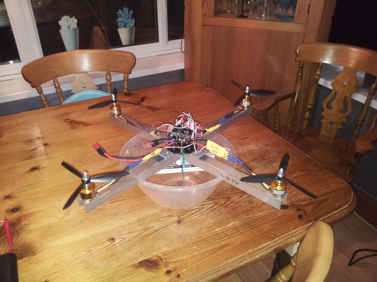

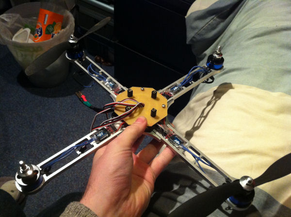

    I've been building this since halloween time going through multiple frames and multiple electronics!
    so I present you my unfinished quad,
    But I can do better then, so I did.

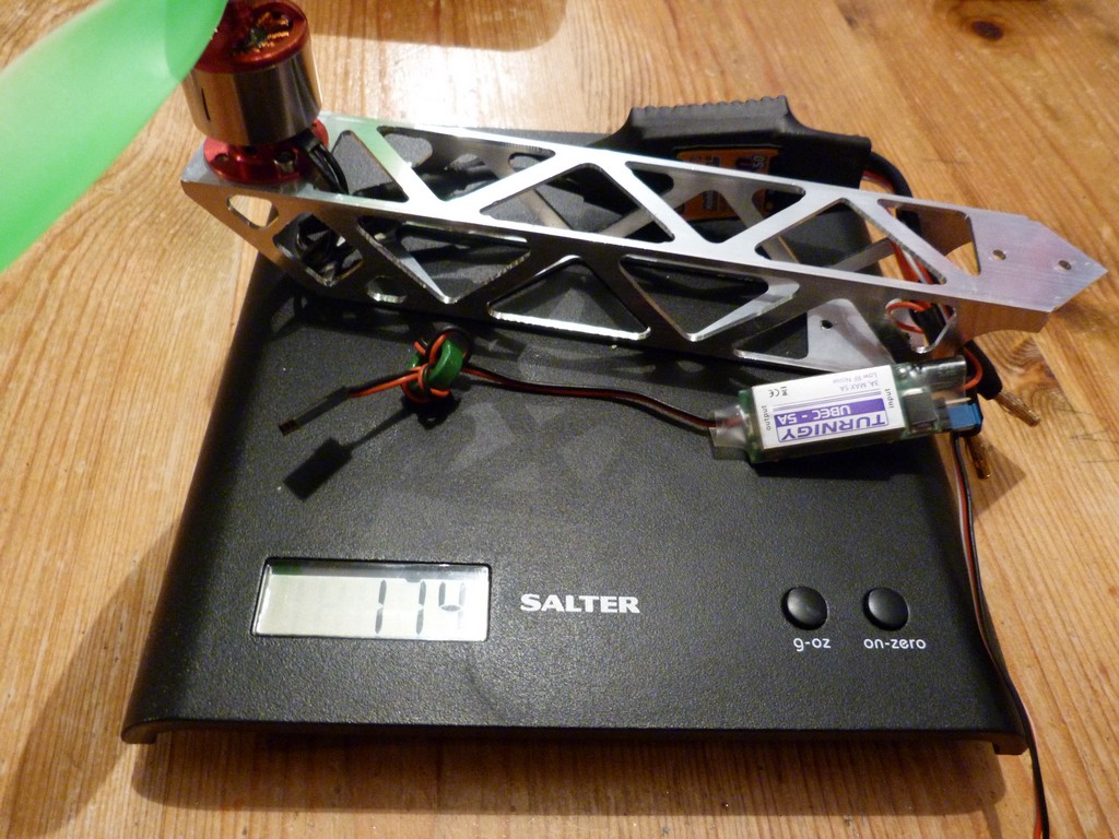

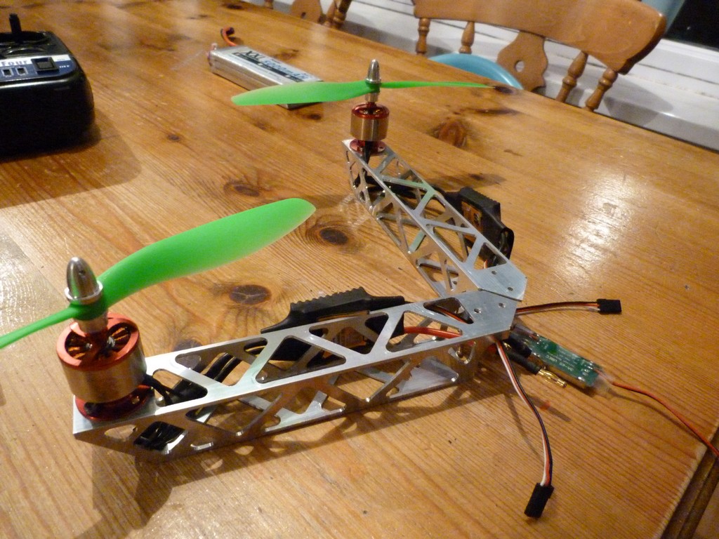

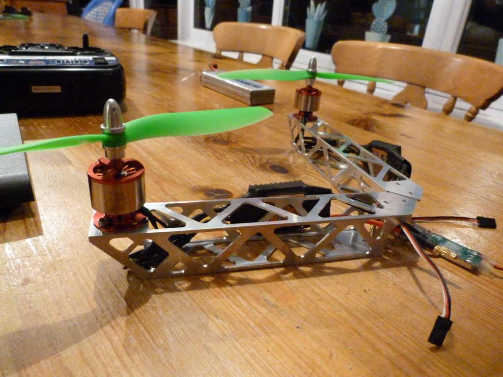

    I haven't finished it yet, but here are some prototype arms I've been making:
ID:	8443Click image for larger version.
ID:	8444Click image for larger version.
ID:	8445Click image for larger version.
ID:	8446Click image for larger version.

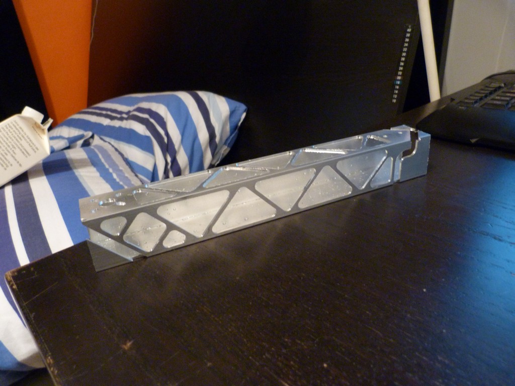

    but these are a bit short now I've seen them in real life and too heavy at about 45gs
    so I'm starting longer but lighter ones

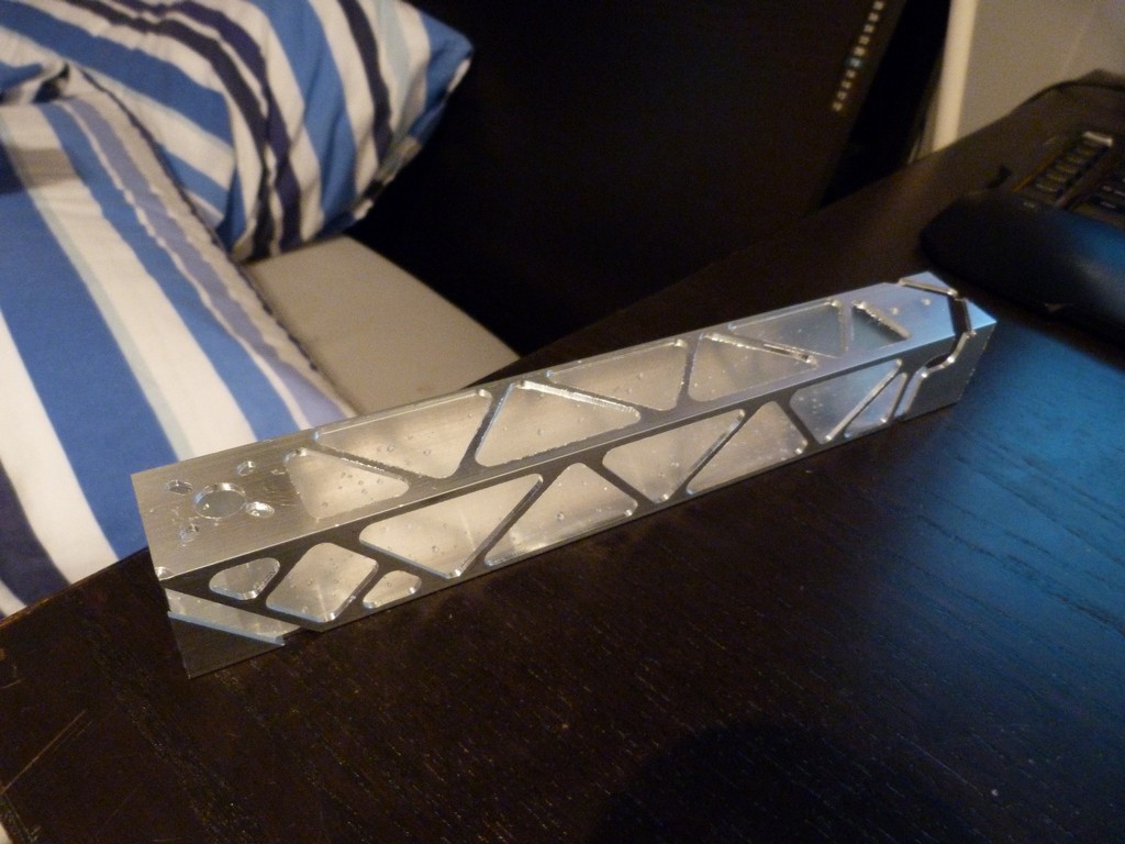

ID:	8448Click image for larger version.
    they should weigh about 30g and are 30mm longer but harder to make. hopefully they wont be too weak, I look forward to destroying a few!

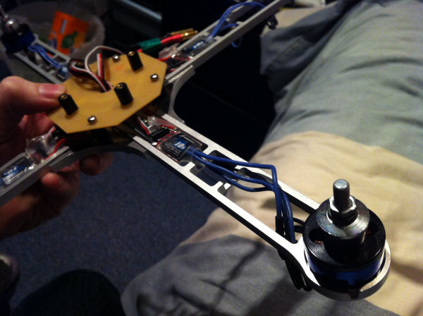

    im just finishing off my quad. yours is looking really nice so far. I took a simpler approach to my frame and it seems to fly really nicely. Got to make a decent battery mount and a couple other bits then ill post some more photos.
    Is there a reason you went with a 'truss' style arms instead of flat ones similar to mine?
    I just thought it would be really cool to have a truss style frame, they aren't too heavy for the quad but it's more of a competition with myself to get it as light as possible!
    I was planning on using the same arms for a hexacopter or larger and have some thing super stable that won't flex in any direction.
    Are your arms 5mm thick aluminium? How much do they weigh? What kV are your motors and the prop size you are running on them? Flight board?

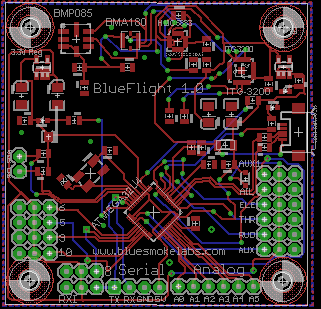

    I'm using a kk 5.5 blackboard with kaptain kuk 4.7 firmware and I have an issue with it. when I increase the throttle, one of the motors will spin up and then stop again. I think it might be something to do with the frequency of the chip not playing well with the esc chip :S
    what size battery do you have and what sort of run time do you get? I was a bit horrified when I looked at ecalc and it said I would have 5 minutes of flight!
    from what ive read it seems the lower the kv the better? i used to use a kk board but i found the multiwii boards iare far more stable, especially when in stable mode (would you believe!). plus you get a nice gui to program them with which is nice

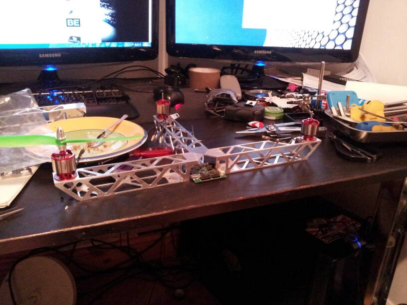

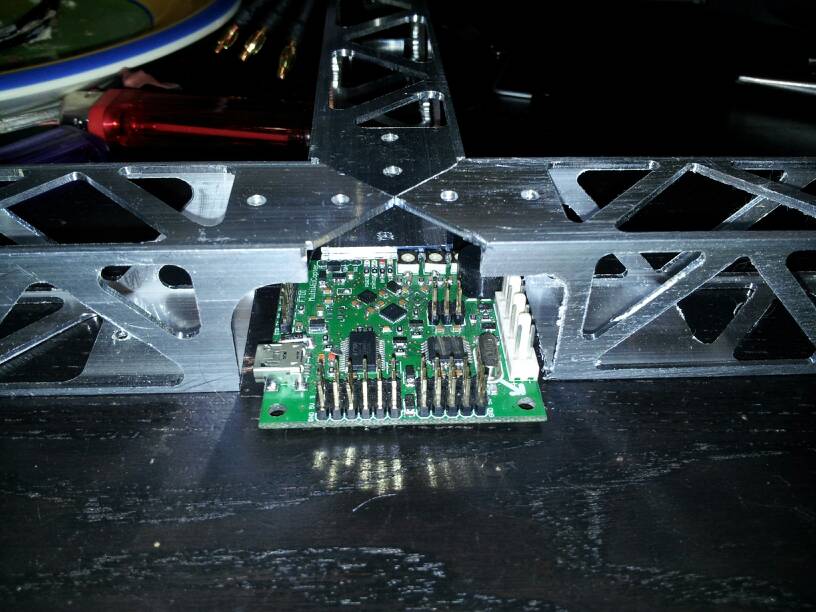

    So I'm 3/4 of the way there!
    Also how the board sits in the frame.
