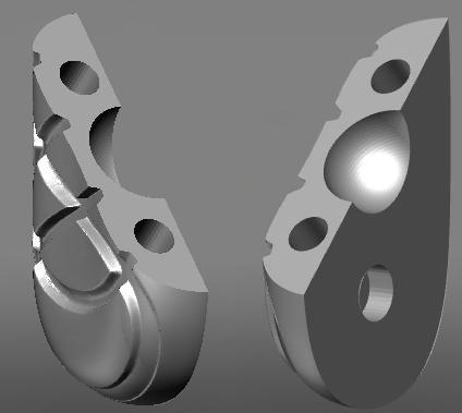

    I have a CAD object that is around 17x27x5 mm in size, it has fairly detailed embossing, a few holes between 3 and 4 mm, and some general cut outs.
    I have contacted numerous CNC machinists in the hope of getting this thing made out of wood, however every last one of them have said its too small for their machines.
    I think I may be lacking the terminology to properly Google search for someone to create this for me, can anyone here help?
    I am hoping to mass produce this little object in wood, but at this stage I am thinking that it may just not be possible.
    All help appreciated.

    Render attached...

    What type of wood are you thinking to use on such a small part with this amount of detail
    Phill
    Does it have to be wood? It would be a doddle to print.
    You could fume it to get a better finish:- Giving 3D printed parts a shiny smooth finish
    Quote Originally Posted by phill05 View Post
    Phill
    I would like to use acrylic pressure stabilised hard wood. Maple seems to be easiest to get hold of, but any really.
    I have had it printed for prototype purposes, but I would like the finished piece to be in wood.
    Tab
    I think you'll find these will be too expensive to produce. Thou small parts they need to be machined on 3 sides which means setting machine 3 times ensuring accurate relocation.
    Also 2 operations are full 3D which takes long time for just a few parts and to do properly in larger volumes will require a special Jig to be made. Again timely and expensive to make, esp if lots are to be made in one go.
    How about a mould and using resin.?
    You sound like you know what you are talking about, so I guess I will have to shelve my dream of having this produced in wood. What would be involved in using a mould and resin? What sort of finish would I get and how would it look colour wise etc...? Is there any chance I could get a wood effect?
    Tab
    I cast some floor panels in resin and then paint them. Most people think they are wood. If you make a wood master and and wire brush it to exagerate the grain, the grain effect should come out in the mould. Despite the small size the mould is likely to be a bit expensive as it will not be an easy one to make. G.
    Yes regards the machining I know little what talking about but unfortunately know far less about the resin casting side.
    I would have thought that Silicone mould would be the best option to give most detail. Make a high quality Master and Like Geoff says exaggerate grain affect thru wire brushing or sand blasting and with a bit of playing around colouring the resin then would have thought should get a good wood affect.?
