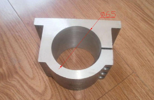

    I' ve come up with an idea to house the bearings for this rotating nut idea:
Name:	spindle mount.JPG
    If I went with Jonathan's suggestion of 7207 angular contact bearings with an OD = 72mm, then I could probably machine this housing myself on my lathe. Once bored out I should be left with a 6.5mm wall thickness, do you think this will be sufficient? After all, the main force acting on this setup will be axial. I was looking at the 7008 bearings with 68mm OD, which would leave me with more wall thickness, but I can't seem to find anyone selling them?? Failing that, would I get away with deep groove bearings?? There seem to be a much better size selection.
  5. #25
    6.5mm would be suffcient and you could use 7007 bearings, but not 7008 for the reasons given earlier. There's no problem in terms of strength from using the smaller bearings, since compared to the bearings you'd use if spinning the screw the ratings are still far greater. Don't even think about deep groove bearings. They're not designed for axial loads. When you put an axial load on one, the balls are forced to ride up on the side of the ring, which isn't ground to such a good finish, so they wear out very very quickly.
    How much have you found that spindle mount for? I could probably get a block of aluminium and bore it for you for less money...
    Have you thought about how to make the shaft? I'm guessing your lathe is big enough, but bear in mind it needs machining very accurately for the bearings and nut with good concentricity. It also needs thread-cutting for a locknut.

    Well, I can get 2 spindle mounts for about £70 shipped, plus taxes if they stop it. I was just trying to estimate how much it was going to cost to have machined from a block and judging from recent work I've had done, ALOT! But if you could do them for less, then obviously that would be a massive bonus! AdCNC has offered to do them for me, so I plan to see him this week and have a nose at his machines while I'm there :)
    Regarding the shaft, I will get this done professionally (i.e not by me) because like you said it needs to be a good fit and screw cut. My Idea is to have a flange at one end to bolt the ballnut to, then a locknut at the other to pull everything together, then the pulley after the thread on a slightly smaller diameter shaft.
