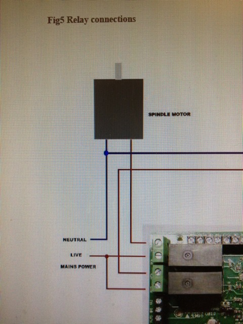

    Hey guys, can anyone give me a step by step or some information on controlling my spindle from the uniport v2?
    I'm looking at having mach3 switch the spindle on when I press start.
    Any info will be greatly appreciated

    What spindle is it.?
    The uniport can only turn the spindle power on/off by using the on board relay it can't control the speed. You need a spindle speed board to do this and even then it can only be used if the spindle has variable speed controller that can accept analog 0-10V to control speed. Vfd's have this option thats why I asked what spindle.

    Thanks for the reply Jazz. It's the chinese spindle with the VFD, sorry I can't remember the brand but begins with an H lol (truth is I dunno how to spell it haha)
    Ok I know the one. Lol . . . In this case then you'll need the spindle V4 board or something similiar that outputs 0-10V signal that the VFD can read. Get the board then come back and we'll see about getting it setup for you.

    Haha yeah that's the one ;-) so I defiantly need a spindle board? I thought I may of been able to switch on via the uni as the instructions on the manual of the uniport don't mention the spindle board just the pic Click image for larger version.

  9. Might work... but the inrush current of the VFD might be too much for the relay on the board... its could be marginal I reckon with a 2.2kW spindle. Also it is very bad practice to start the motor by switching on the VFD! You could probably, and more safely, use the relay to control the 'soft start' input on the VFD (might be labelled 'RUN' input). Then you will have to turn the VFD on and set the speed before pressing Start on the PC...
    Could you give me an idea how to do this? Is it just the case of finding the wire which enables the run command on the VFD? And wire that to the board as in the pic?
