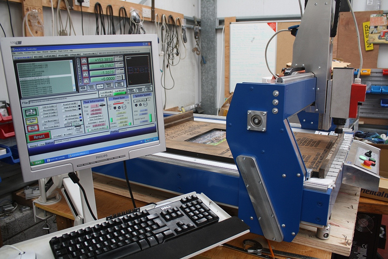

    My name is Rory Stoney and I am pleased to announce that the JBEC CNC ROUTER platform is now available in the UK via StoneyCNC (STONEY CNC · ROUTER SYSTEMS). The JBEC CNC router platform is based on a German platform design and is assembled in Kilkenny in Ireland in affiliation with JBEC. JBEC (John Brennan) has had 30 years experience in the automotive industry and has full industrial fabrication facilities in house allowing us to assembly and customize machine design with exact professional tolerances in house on a 3D Hurco machine platform. Within JBEC commercial machining work is a core competence and we therefore understand the challenges associated with machine building and the associated design challenges.
    The machine is based on 80mm x 50mm box section bed frame construction design supporting the gantry and T-slot aluminium bed. The results is a very stiff robust platform with excellent accuracy and stiffness translated to the cutting tip - the key to good CNC router performance. The platform has had great success since its release in Ireland supporting many new and growing business opportunities.
    Our standard machine is controlled using high spec Oriental-stepper-motors driven by Leadshine drives on all axes - feel free to ask for more information. We adopt a 24V DC latched on/off circuit on all out machines as standard as safety is out no.1 priority. We also offer a servo stepper version where extremely high performance is required.

    I have had experience in CNC for a number of years and have experienced a range of low cost machines. I would view our platform as potentially one of the most high performance in the sub 10,000€/£ range - I'm very open to and would welcome comments/challenges on the back of this statement.... our platform is a standalone unit - no alignment or hardware assembly on site is required. The machine will be delivered and will perform to our stringent quality checks on site within minutes.
    We acknowledge that our platform typically comes in more expensive than others in this category but we view it a full professional system within its price range and we do not compromise on the system design. Machining / cycle times can be thrashed with increased feed rates without compromising the quality of the machined part.
    The video below shows our stated repeatability down to 0.02mm. The efficient transmission of torque via ball-screws through our stiff frame maintains the repeatability during cutting operations at high feed rates. Repeatability values as you all know must be translated into cutting operations for stated accuracies to prevail in practice. A dial gauge does not challenge the gantry stiffness it merely gives an indication of the drive and gantry efficiency.
