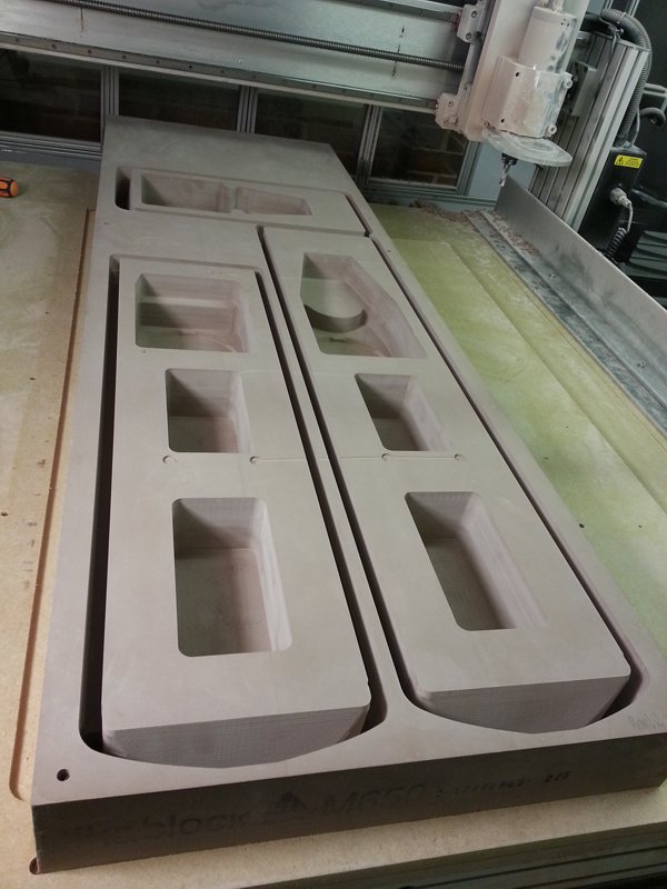

    This was a cool challenge not least because there was over £300 worth of stock material at risk if I nobbed it up!
    A couple of days worth of planning, many iterations of tool paths and simulations and a day spent building and testing the double sided jig. This made a really nice change of pace from the usually slap a sheet of 4x4ft on the bed and press go. I've only had practical hands on experience with the cnc for the past few weeks and only done a handful of jobs so at time I thought I'd bitten off more than I could chew with this but it came good in the end. The two sides lined up virtually perfect and I couldn't be happier with the results. I learnt a lot from this, not least that long cutters (105mm from the collet) are whole other ball game and first hand experience of the superiority of carbide vs hss when cutting highly abrasive materials as well as the folly of using too many flutes and incorrect chip load. Burned two cutters up because of that just on this one job.

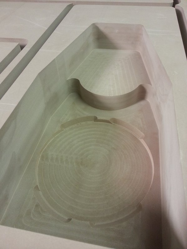

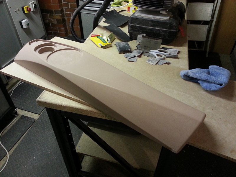

    And a couple of pics

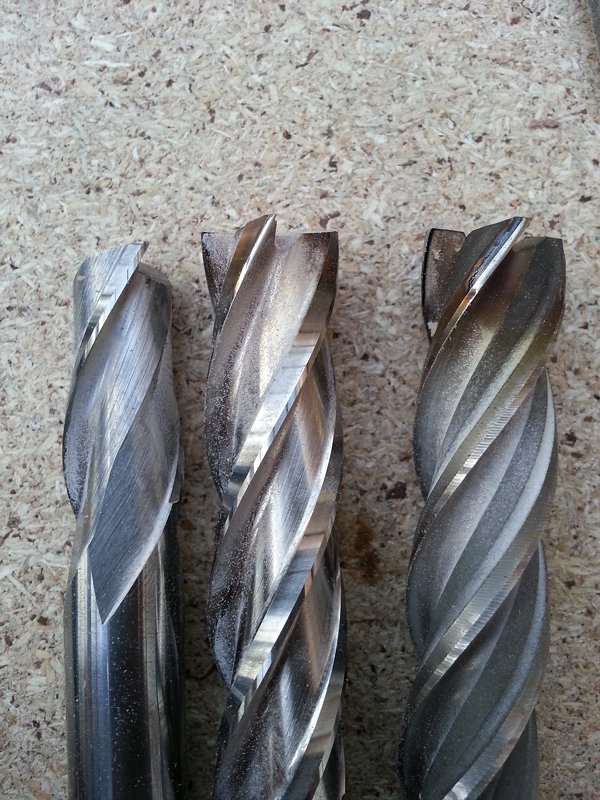

    And the two dead cutters. HSS isn't really suited to this material as its even more abrasive than MDF but a combination of 4 flutes and a hefty 105mm cutter stick out meant you couldn't whack up the feedrates to anything like what they should have been without massive tool deflection or possibly even snapping the thing. My fault of course, tool was totally unsuitable for the job but I got them cheap so couldn't pass. A 14mm dia 160mm long cutter with 100mm flutes would normally set you back £50+. I expect doing a finish pass in alu would have suited them much better! lol
    Check the carbide 2 flute on the left though. Not a scratch on it and it ended up doing most of the work. Yup. In my initial set of toolpaths I naively thought using the long cutting to get through the whole material was a great idea - save time changing bits, keeps the code simple and smaller. Wrong! You really only wanted to be doing the bare minimum with those massive cutters, just the parts where only they can reach. Anything else, use something smaller! In the end I broke it up into three tool lengths, one at 40mm another at 75mm and the 105mm. That worked but for the profile around each part there simply wasn't enough room to clear the chips when that valley got deep and it started burning cutters within minutes due to massive rubbing and recutting of chips. In the end I had to flip the part over and come at it with the 40mm carbide cutter from both sides leaving only 20mm right in the middle for the long cutter to get at.
    In hindsight there would be a couple of things I'd do differently. First off is pick up a carbide 2 flute long cutter and the other being to size the stock to just over the size of the part and that'd do away with the deep profile problem I had.
Name:	Baffle Masters 13.jpg

    I noticed in the video you've got the plunge rate for the cutter set really low compared to the horizontal feedrate, so when the machine is ramping down it takes forever and doesn't do the cutter much good as the chipload is tiny. For this job, in the whole scheme of things it's not a big deal, but if you're cutting a harder material it could even cause the tool to break, so get into the habit of setting the plunge rate about the same as the feedrate (maybe a little less) so it doesn't slow down. So long as you don't forget to tell the software to do ramping it will work well.
