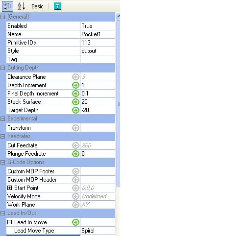

    Just playing around with cambam while I am waiting for parts for my CNC driver.
    I don't usually have a problem with this. It is probably a very simple one to work out. But I just cant see it.

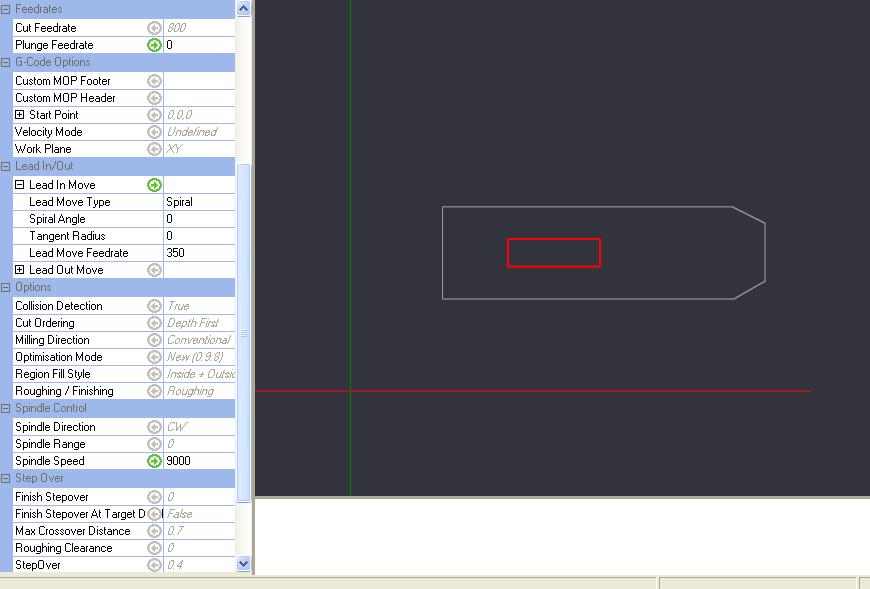

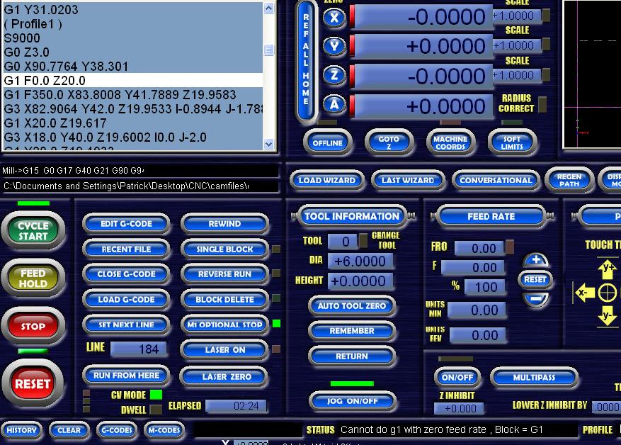

    I designed a simple table clamp in cambam, and produced the G-code for Mach3. Mach3 sais "Cannot do G1 with 0 feedrate,block G1".
    I went back to cambam and checked. My feedrate is there 800. Spiral down feedrate 350. I set the plunge rate to 0 as I don't want plunge as I am using Aluminium.

    Plunge means move Z
    No plunge rate means the tool wont move, set it to 350 also.
    John S -
