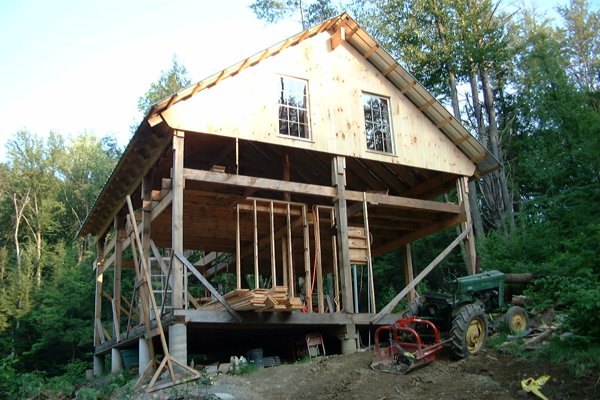

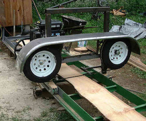

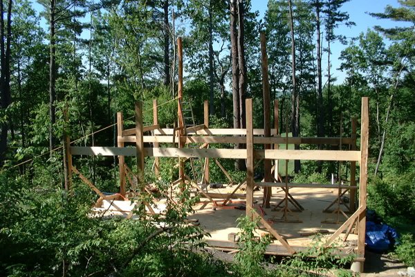

    Here are some photos of a sawmill I built several years ago. Log capacity is 28" dia. and bed length is 20 feet. I can extend that with more sections, but generally use an Alaskan mill for long timbers. I built my house with lumber cut from salvaged downed trees on my property left by a really incompetent logging company, the prior owner. The mill took 2 weeks to build and cost about $800. It will cut a 18" x 16' long pine board in about 50 seconds. Hardwood somewhat slower. I run the governed motor at 2700 RPM, though it is rated at 3600.
    The fixed spindle is a trailer spindle. The drive is a go-kart axle and hub assembly. Driven wheels are trailer wheels and tires. The engine is a snow blower horizontal shaft Subaru-Robin 10 Hp type. Large reduction pulley is 2 sheave 15", and was a surplus item found for $15. The guides are made of 3 ball bearings. Two smaller sets that the flat of the blade rides against, and a larger bearing that the back of the blade contacts. The blade guard is a trailer fender. The vertical adjustment is made by a used boat trailer winch.

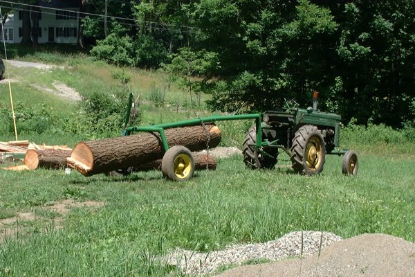

    I also built a log arch out of a mobile home axle and a bent heavy steel tube that I found at a scrapyard -- I think it was once part of the derrick for a tow truck. I couldn't straighten it, even with heat so I faced it up. I guess it is a log arch in two senses of the phrase!

    Do you tension the blade by inflating the tyres (tires) a bit more?
    Hello Boldford!
    That's a very frequent question. But no, the tires are maintained at constant pressure. The non-driven spindle has adjustments for both axial angle, and distance from the driven wheel (blade tracking and blade tensioning), just like an ordinary bandsaw.

    I'm more impressed by the fact that you built your own house!! Awesome job.
  9. #8
    Fantastic!!! Well done. G
  10. #9
    Yep, another one is is impressed with not just the saw but the house as well. Thanks for sharing.
  11. #10
    Amazing, so not only have you built your own house, you're dropping trees, sawing the timber to size then using them to build it. The almost free house.
