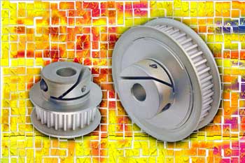

    iv been looking for the best method of connecting my timing pullys to the stepper mators and ball screws.
    on my first build i used grubscrews directly onto the shafts and had problems with them slipping and recking the end of the shaft/screw

    the question is has anyone had any any experiance for these ?

    Another option is clamp style ones. e.g.
    http://www.sdp-si.com/web/email/fairloc/index.htm
    But not seen anyone selling them cheapish...
