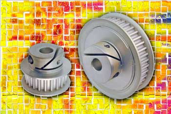

    Another option is clamp style ones. e.g.
    http://www.sdp-si.com/web/email/fairloc/index.htm
    But not seen anyone selling them cheapish...
