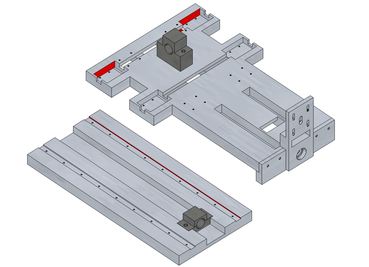

    Ok Im not going to hold my breath on this one but i will put it out there anyhow.
    I am inviting quotes for my Z axis. There is room for change if it is needed.

    These plates are 40mm plate 520mm long x 360mm Wide.
    Any questions let me know
    Rick
    PS.. more information can be seen in my 7X4 Combo Thread but please post questions about it here or PM me

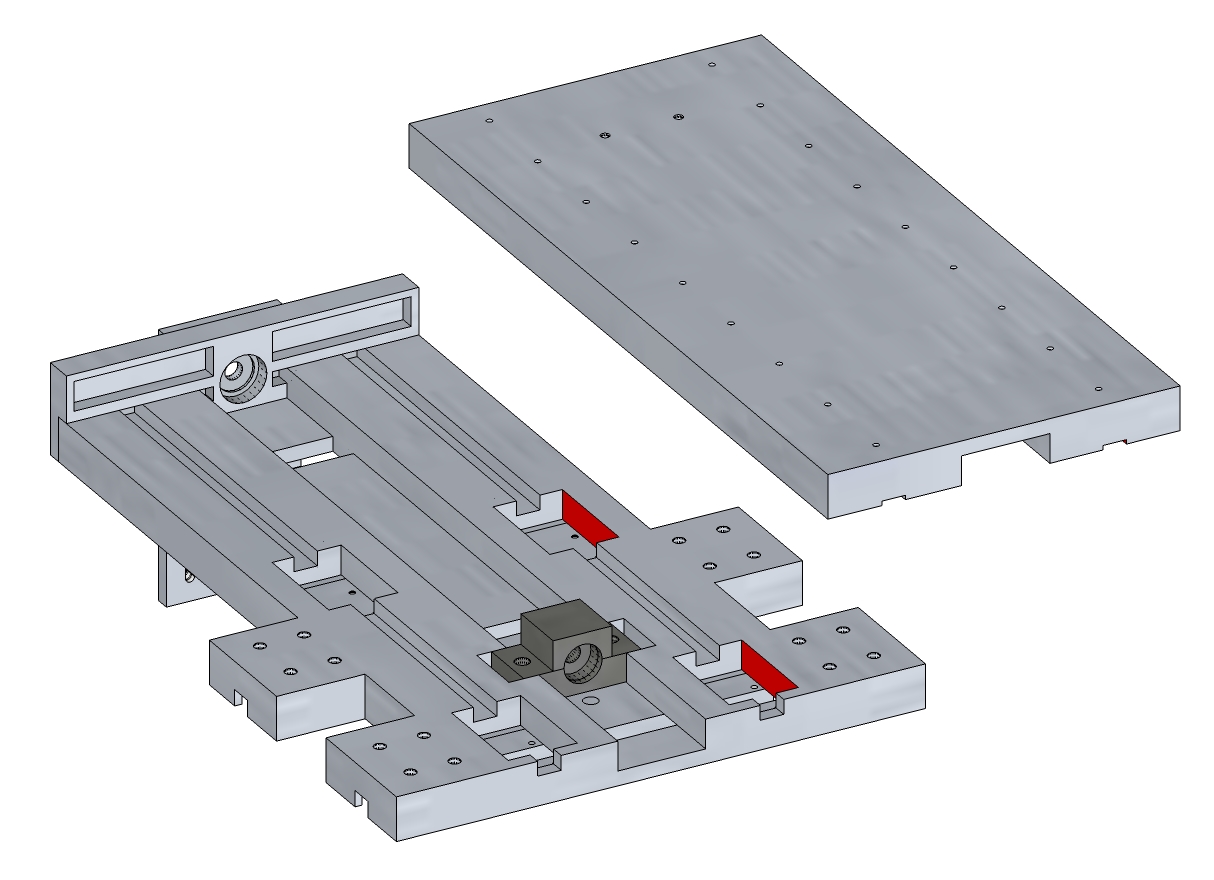

    Hi all, well ive been asked a few questions about the pockets and things. Ok the drawings i submitted above are were the concept Sketches only (although pretty complete), so here are some more complete designs to clarify things a little more.

    The red shown are reference/datum surfaces only.I am also happy to provide the material for the job.

    Just as a side note as i'm following your build log over there >>>, so read the posts about the pockets for the bearing units to fit in, i.e round cutters vs square corners, what you can do is over run the corners of the pocket with the cutter in both directions, this dosnt look "great" but if done well it can and allows the corner to fit into the pocket.

    Cheers Lee, I have made the pockets big enough to compensate for the corners. I will even be providing the files to do the job and if whoever is doing has V-Carve then all the better as that is what I've done it in. that's not to say I cant provide the drawings in other formats as the above drawings will show.
    Whoever gets the job will get the added bonus of being able to produce some very nice Z-Axis.

    Rick, how big are the backplates. mouse hover reads 1214x880 @ 60%. BTW the design looks fantastic, G.
