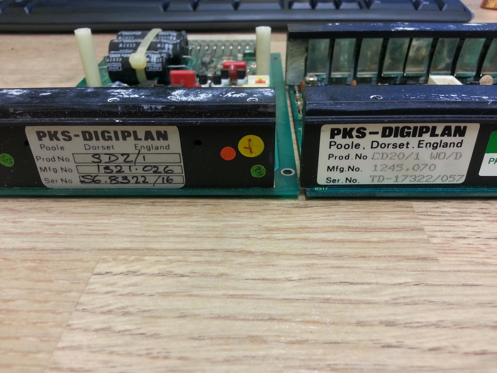

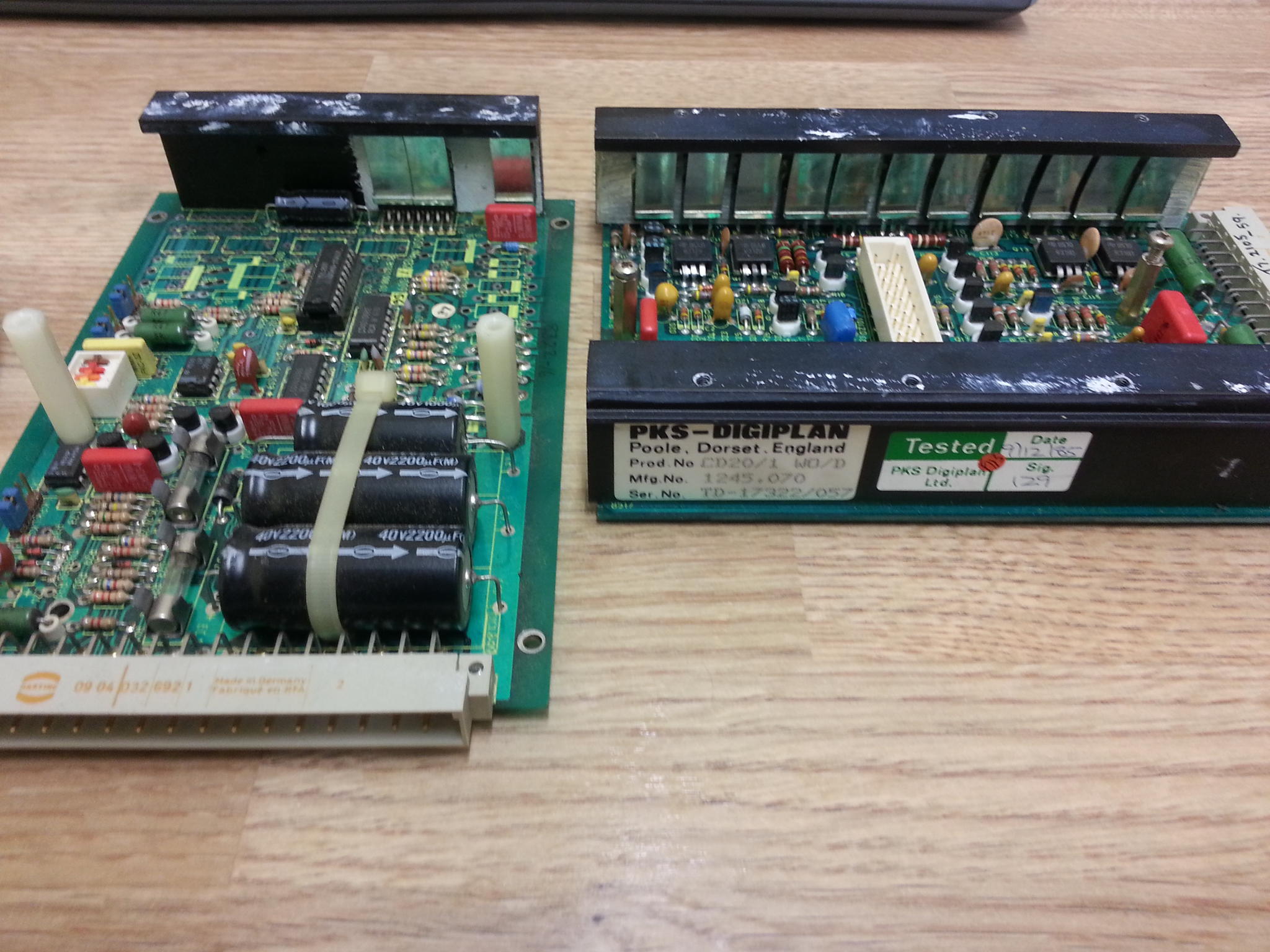

ID:	8567Hi Asto, this is a bit strange.
    I've posted some pics of an SD2 with a CD20 next to it. The cd20 has another board in the centre of the two heatsinks which is removed to show the main board, this board has four leds on the left hand (rear) edge.
    The Denford Orac used both types of drive, the cd20 version has a higher voltage psu (around 65v-80v), and the sd2 version has a 35v ish psu.

    i2i...the second pic from left to right and the 4rth are pretty similar to mine almost identical but i see the white plastic socket contains three lines of contactors. Mine has two connecting the main board where the high power transistors are with the signal processing board where the logic ic's are located and the leds are on this one the one on the top. You re right!
    The first pic that i sent was borrowed from the internet not real mine...So it looks you have some point here.
    The one with the exposed PKS0320 was taken by me few days ago.
    I can send you new photos that i can have from my machine tomorrow.
    The first board though which i see must have come off a Triac mill. My Triac uses them because I can see the driver ic there covered under the flat springs. It is the L298. I had to replace this once.

    ...My Triacs are not R8 machines I have two of them. One was built in 1985 and the other 1987. The newer I bought from G and m tools but Z axis failed after a while.Thought it was the stepper motor and replaced that with new Sanyo. Then I found the L298 dead.
    Replacing this IC was not that easy in double sided board.
    Sorry about the first picture. It was not taken from my machine. You were right.
