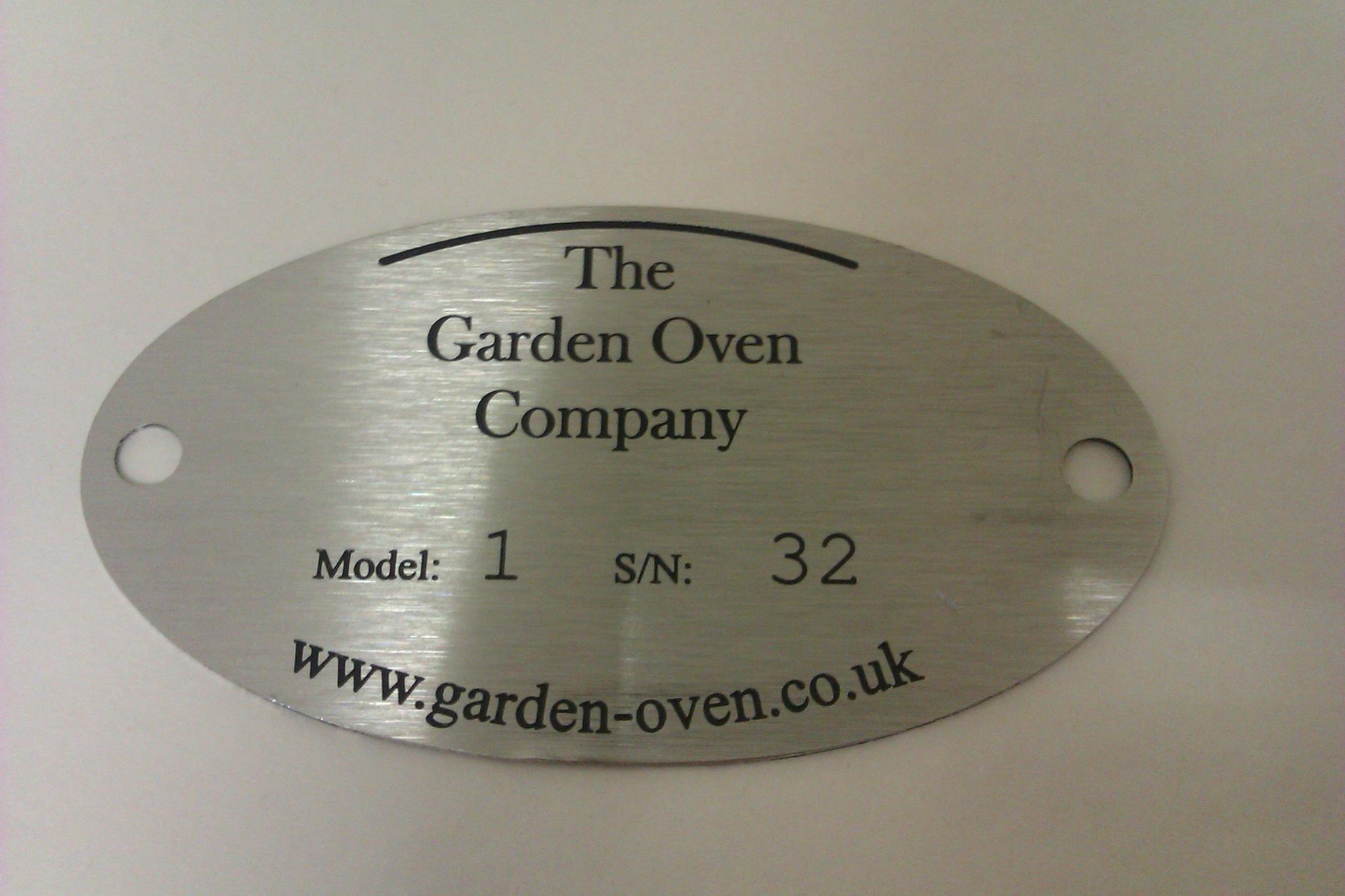

    I would like to engrave lettering into small plaques (about 80 x 45 mm) of stainless steel or brass. I currently have them made by an outside company but this gives me no flexability in doing cusomised lettering. The engraving is deep enough to be infilled with paint so that the print really stands out.

    Can this kind of work be done with a CNC router? With proper tooling are there any machines that might fit the bill for under £2000? Are the CNC routers I've seen on Ebay from china up to the task of engraving in stainless steel?

    Brass is easy to engrave with a CNC router, however stainless steel is much more challenging since the cutting forces are greater. The machines on eBay from China would be fine for engraving brass, but would struggle with stainless steel due to their high spindle speed and poor rigidity, so you would need to make some upgrades. That may still work out cheaper than making the whole machine yourself, so I would compare the price of the components to find which is the best option. With the right tools the spindle being limited to relatively high speeds may not be a problem.

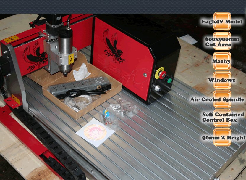

    That looks crazy good for the money! Profile rails on all axis, steel construction (though can't see geometry under the covers of the gantry), flood coolant ability. Very nice indeed. Though I just noticed, only one bearing block per rail on the Z axis... possibly on all axis!

    I have the Eagle IV from Redsail which I use mainly for cutting foam. Never tried SS.
    But if you require any further info just let me know.

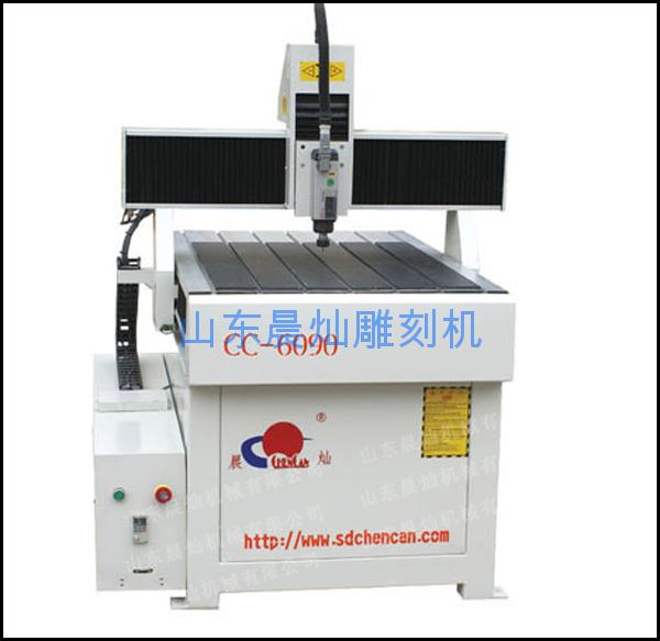

    We are manufacturer of cnc routers in China. Here is a cnc router i can recommend CC-G6090 for sign making.
    Working area:600*900*80mm,any questions just contact with me
