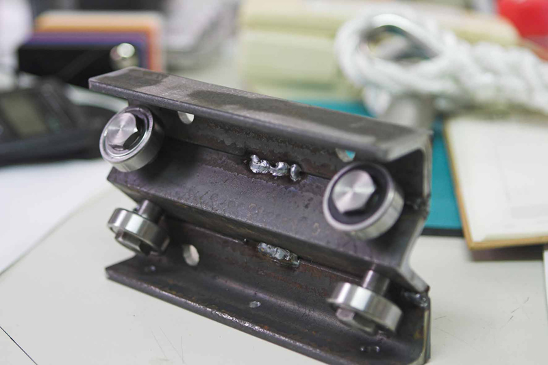

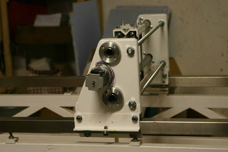

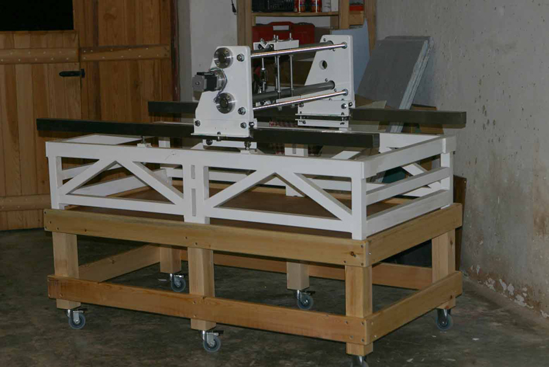

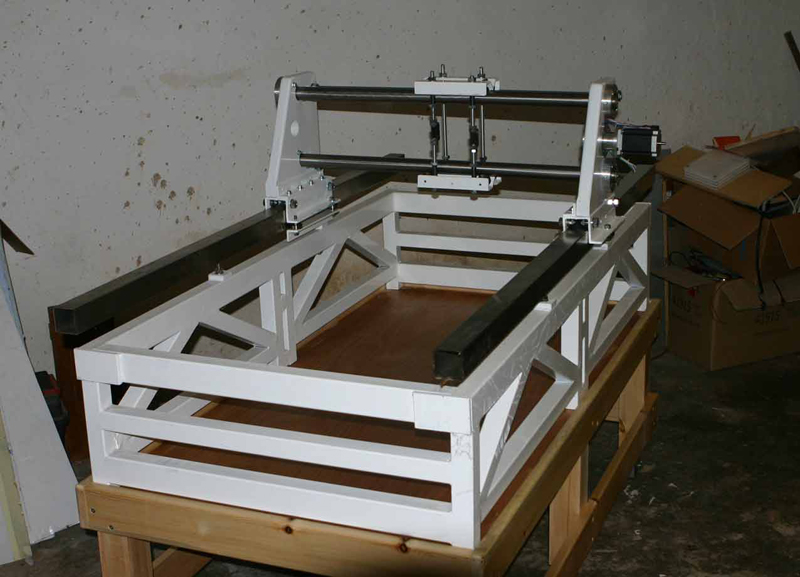

    Thanks for input smiler, I'm pretty much committed to twin drives at this time but if things do go pear shaped i'll think about doing the mod you suggested, maybe even R&P. Have attached a couple of pics to show progress...Rod
    Rod,
    That looks like a really nice build you have going. Please consider starting a build thread. I'm slightly taken aback at how similar both our designs are :)
    What materials are you using for the framework and the gantry and what sort of size bed etc? Enquiring minds need to know....;)
    I'm just about to start building my main support frame. Heavy section channels and angle to increase rigidity.
    Thanks for the photos anyway.
    Jeff.
    Rod, that is a very nice build. Please more information and pictures.
