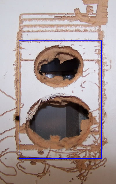

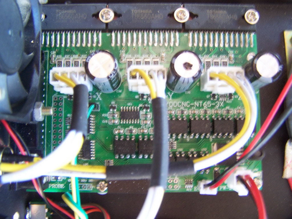

    Sorry, I was bein' a sarcy clever dick re the straight line reference I've attached another pic as to what it does. I thought if it can't engrave something, surely it should be able to cut out a 52mm diam hole a 39mm diam hole and a rectangle around the pair so I could make a vacuum hose mount - boy was that a total failure. My son-in-law's da used to work in the tool industry and knows his way around g-code so I showed him the g-code to make sure I didn't have any errors and to the best of his knowledge it should do just what it's written for which is making me lean toward the controller not doing what it's bloody well told which is probably Karma comin back for me for bein' the same as a kid
    The blue line in the image is where the rectangle is SUPPOSED to be, as for the holes well they're just plain outta shape. Oh and that was a scrap piece of MDF so try and ignore all the other lines at the bottom of the image and the upside down letter in the top right etc and you will see what happened to the rectangle

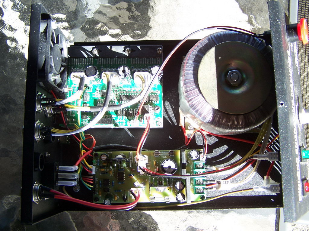

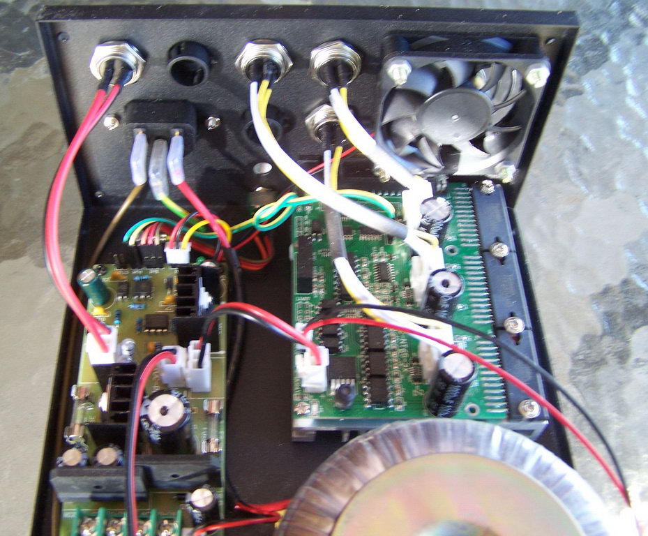

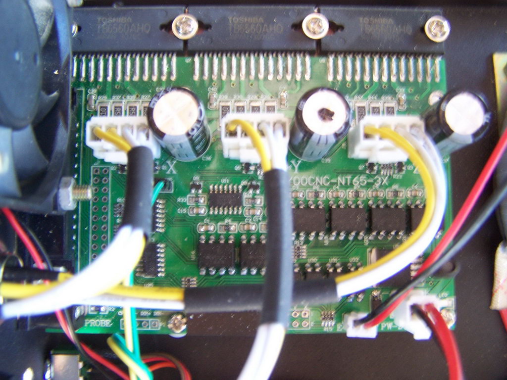

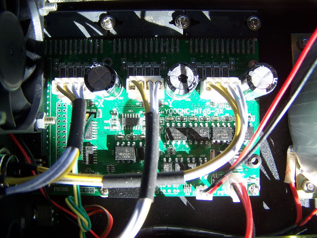

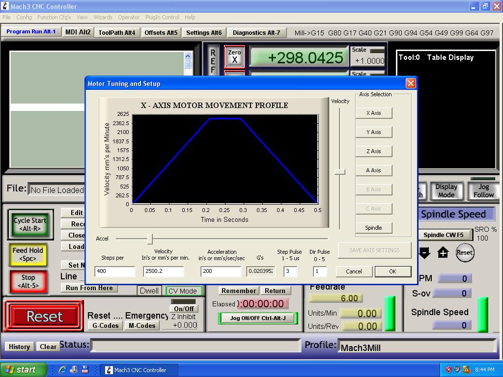

    OK we need a DECENT picture of the stepper board in the controller box from vertically down, hell take 3 or 4.

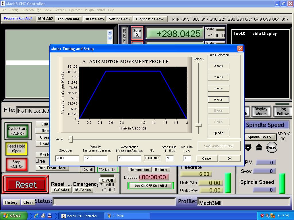

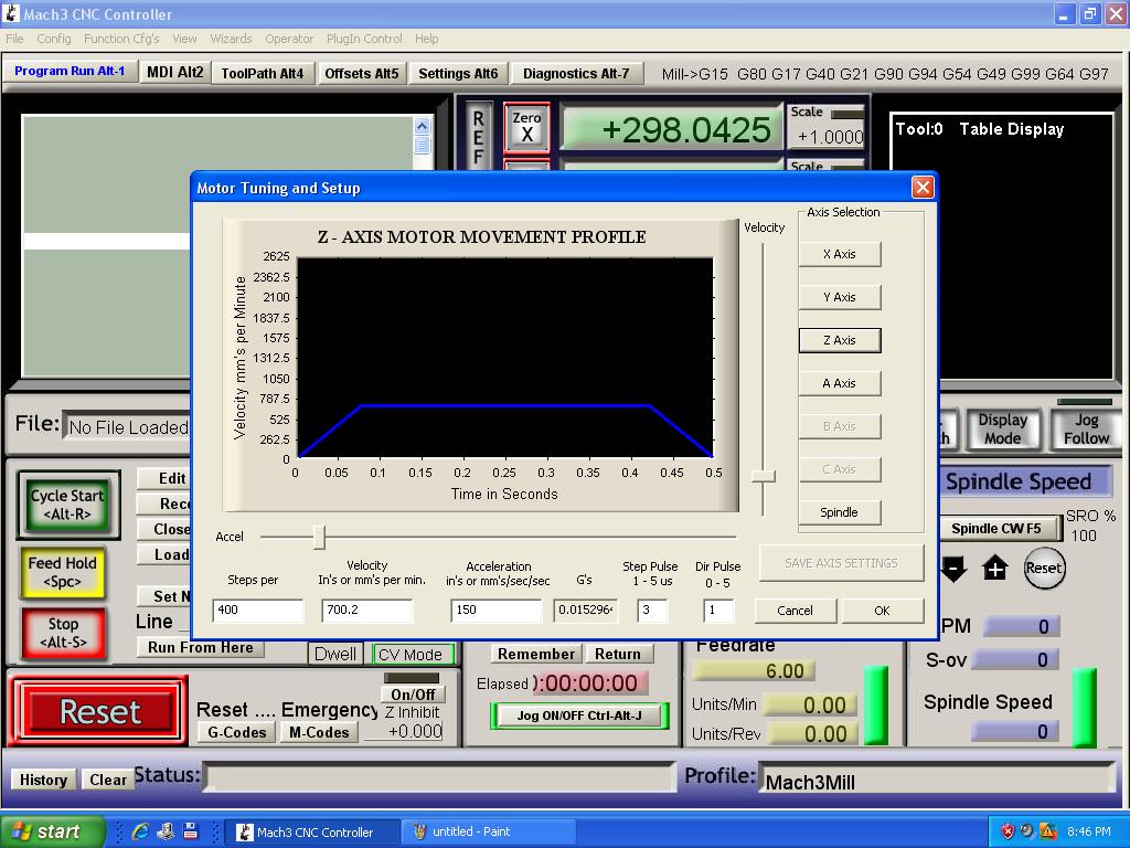

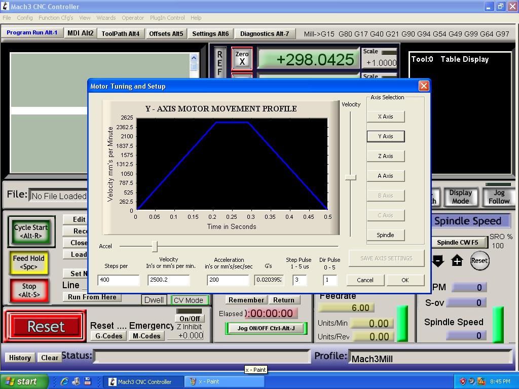

    then we need a screen shot of the setup page in Mach.
    That's Config > Motor Tuning
    Next double check it does have ball screws and the pitch is 4mm

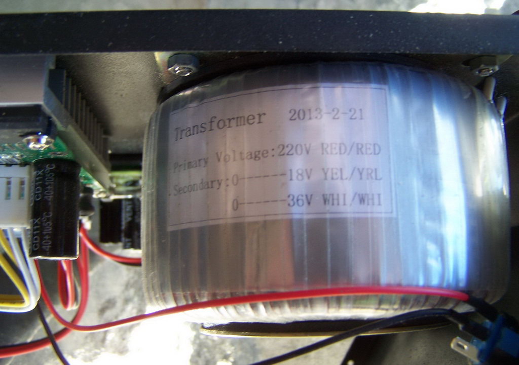

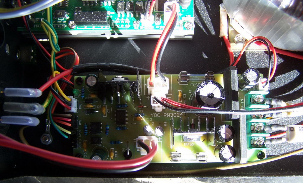

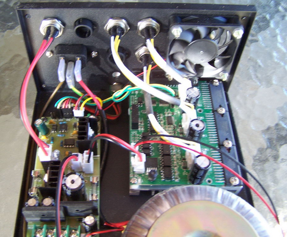

    Last things first, short of tearing the machine down to measure the screw I got no idea if it's 4mm or not but going off appearance it's def a ball screw. The Config > Motor Tuning is set to machine manufacturer specs as shown in the manual that came with the machine.
    As for images and screen caps here goes...

  7. #16
    Mach setup looks OK

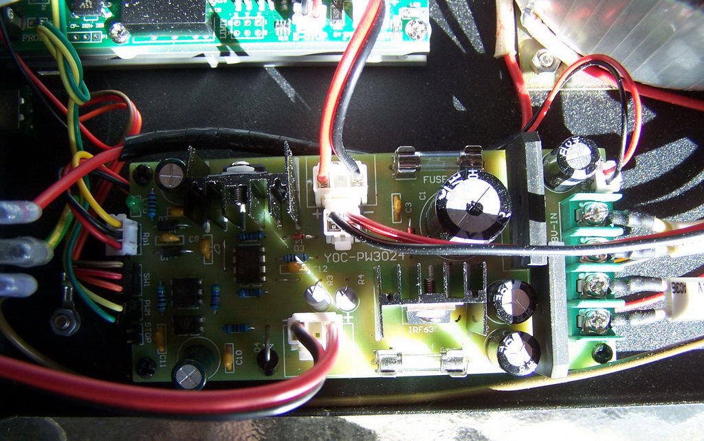

    Pics don't really show anything.
    010.jpg is the best shot, I'm looking for dip switches that set microstepping. X and Y should be the same if the screws are the same and the motors are both direct drive.
    On the picture of the circles, is the wide diameter X or Y ?
    If it's X change the steps per on Y from 400 to 200
    If it's Y then change X from 400 to 200 and run the file again.
    Remember to click save settings, then OK and reboot.
    Off to bed now, it's half past dark here, can you play quietly with yourself until morning ?
    Def no dip switches anywhere, I'll have a muck about with changing the steps and see what happens and post results - and I never play quietly, the volume is always set to 11
