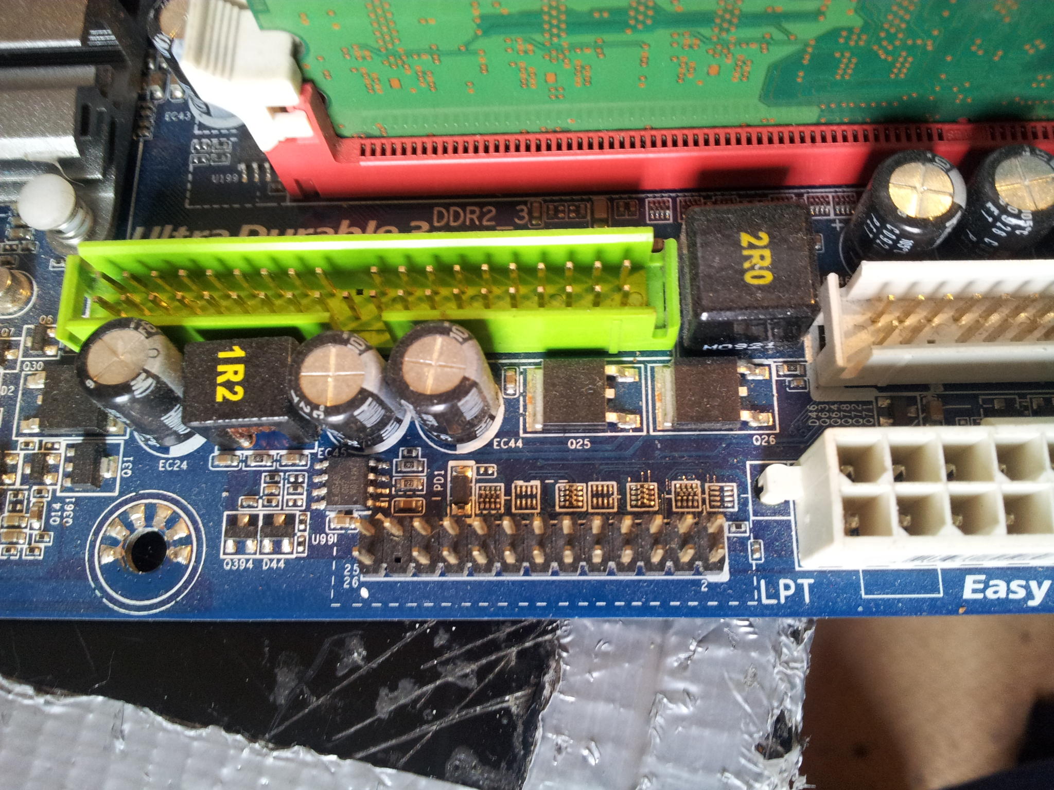

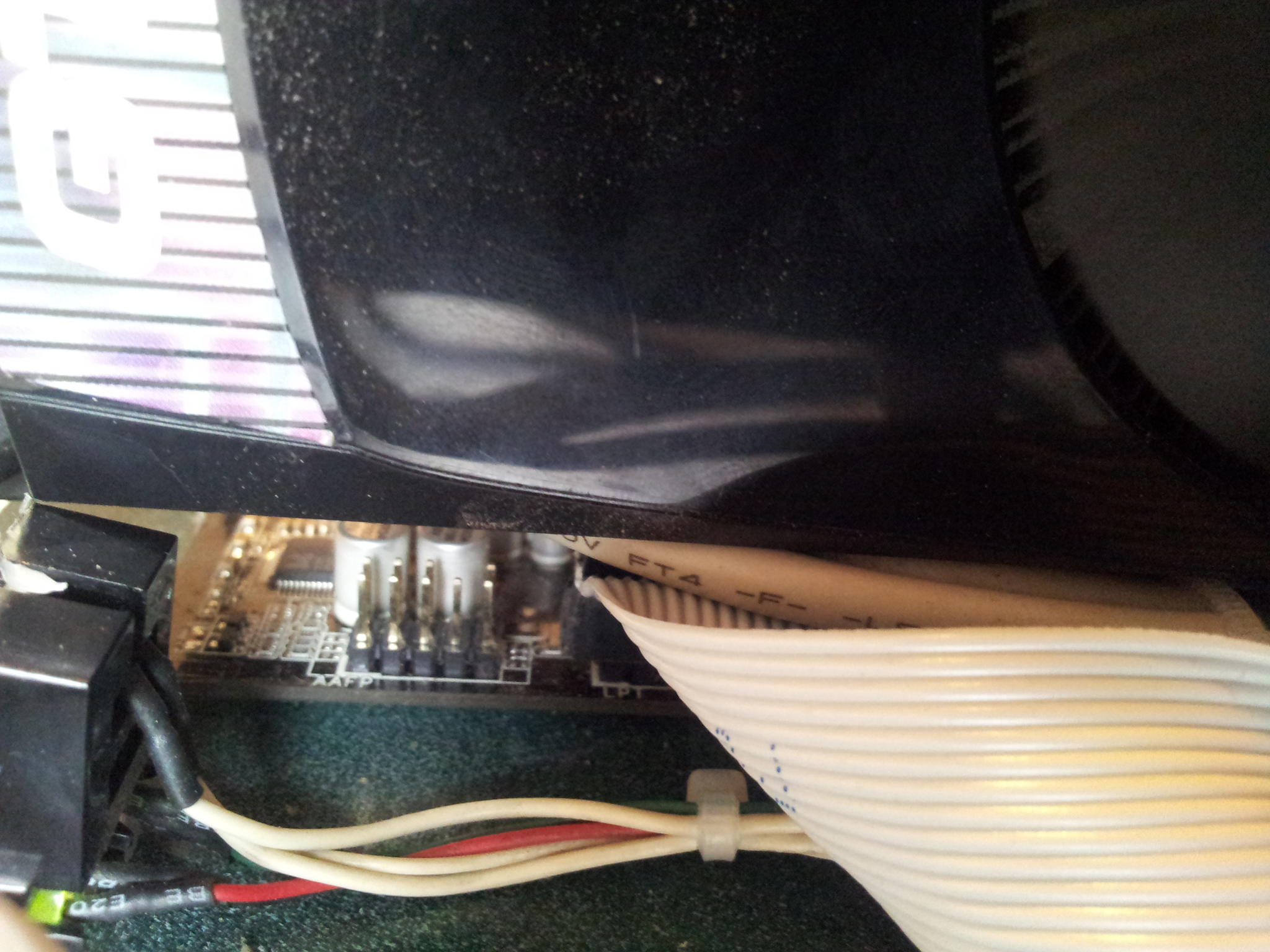

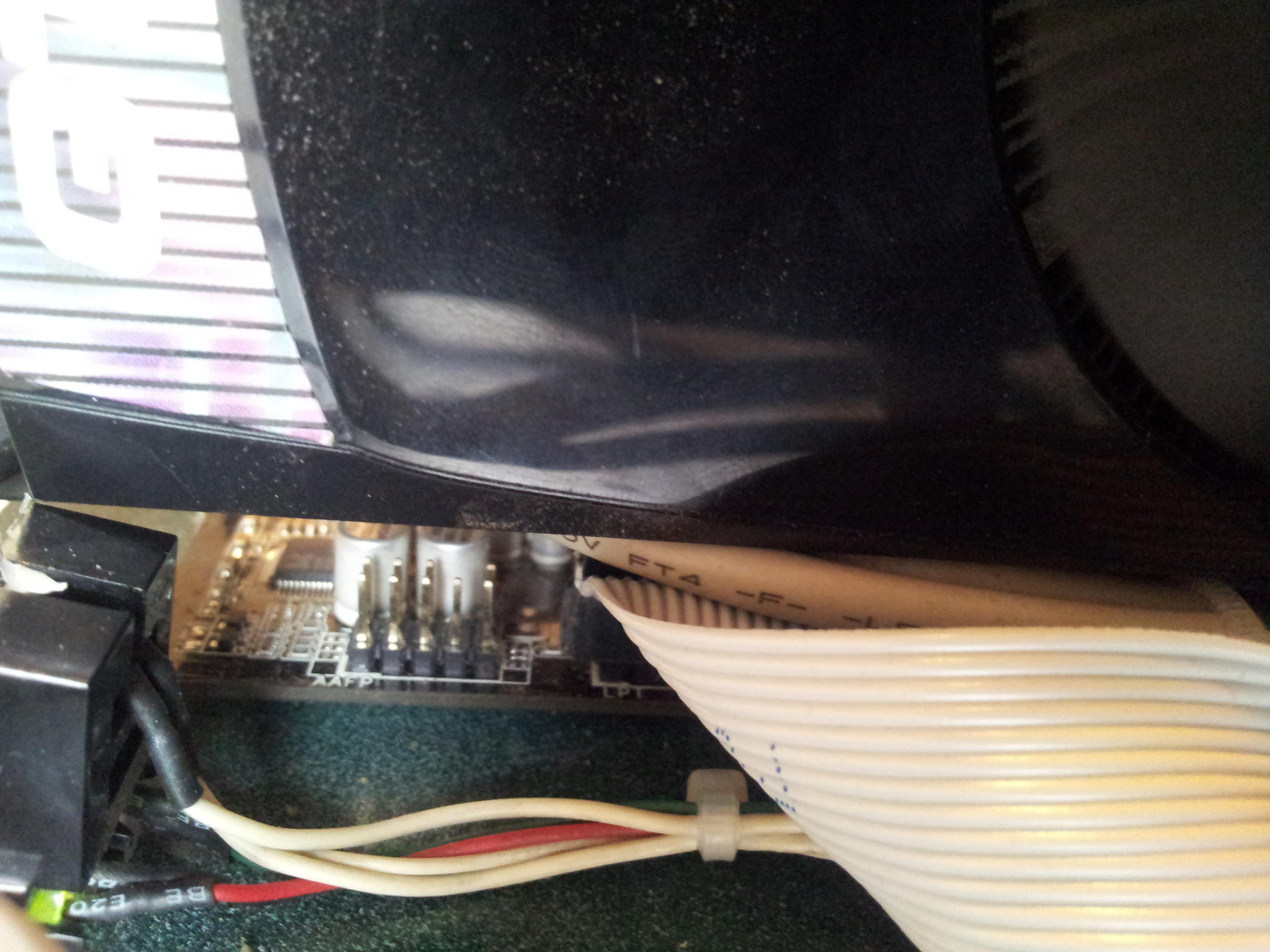

Good day to you all. Long story short I have a new pc with Win7 running so I was lost when I ordered a pcie Parallel port card of ebay and for the life of me could not get it to work, I tried everything but to no end would it work!! Just as I was losing hope and getting ready to fork out some more cash on my CNC project and buy a pc with a parallel port I stumbled across a post saying check you MoBo maybe it does in fact have one, I cannot give credit to the post as it was 3am and after reading a million posts but my MoBo did indeed have just that a LPT1 parallel port hidden under my graphics card. It just looks like any other I/O connector never paid attention to it before! So I checked my other three MoBos I have from other projects and low andbehold They all have Them. So download your MoBo manual (pdf) and search for Parallel port and who knows a massive headache solved.
Main MoBo: Asus f1a55-m le
Second MoBo: gigabyte ga ma785gm us2h
Third MoBo: ECS G31T-M9
