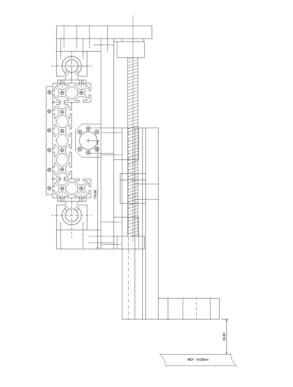

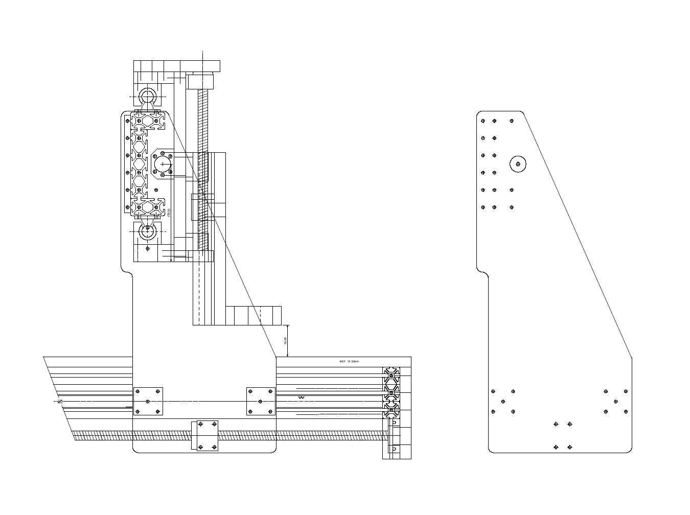

    Hi all,
    Here is my new drawings for my 1100mm X 700mm X 300mm CNC, the only thing that I kept was the bed, everything is new from there.
    I lowered the height of the gantry the Z axis from 125mm to 55mm (that's back to the height that I had my very first drawing) from the bed that should let me put a thin mdf board as a sacrificial board. The travel in the Z axis is 110mm.
    The gantry sides are made out of two 20mm thick plate aluminium which will be bonded and bolted together, the first one is solid the second one will be lightened. The Z axis will also use 20mm plate aluminium. The backing on the Y axis is 12mm plate aluminium bolted to Aluminium Profile Extrusion. And the X axis can easily be stiffened buy adding more Extrusion to the Bed if needed.

    A quick thought!
    Flip the 'Y' axis (top to bottom) arrangement over and add another plate to the back to mount the ballnut and you will always have a nice clean screw
    Looks good mate. are you happier with this as well?
    Whilst myself and others could carry on making suggestions to tweek if further I think you have got to the point of a build-able machine, without going into calcs you have gone as far as you can.
    The only point I would make and it is minor and that is that you might need to add additional support to the top of the X axis bearings to stop them opening up due to the weight of gantry, placing the rails and bearings on their side will improve load capacity but some of the cheaper bearing holders can give and open up the bearing.
    I apologise for misleading you with the table distance as I presumed you meant with the z axis at the top of its travel. I see from your drawing you are talking about it a full extension.
