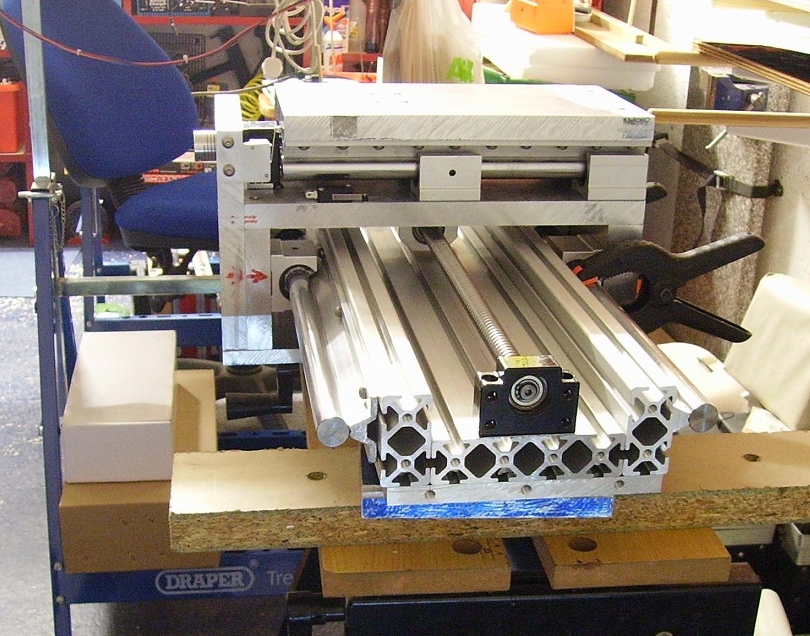

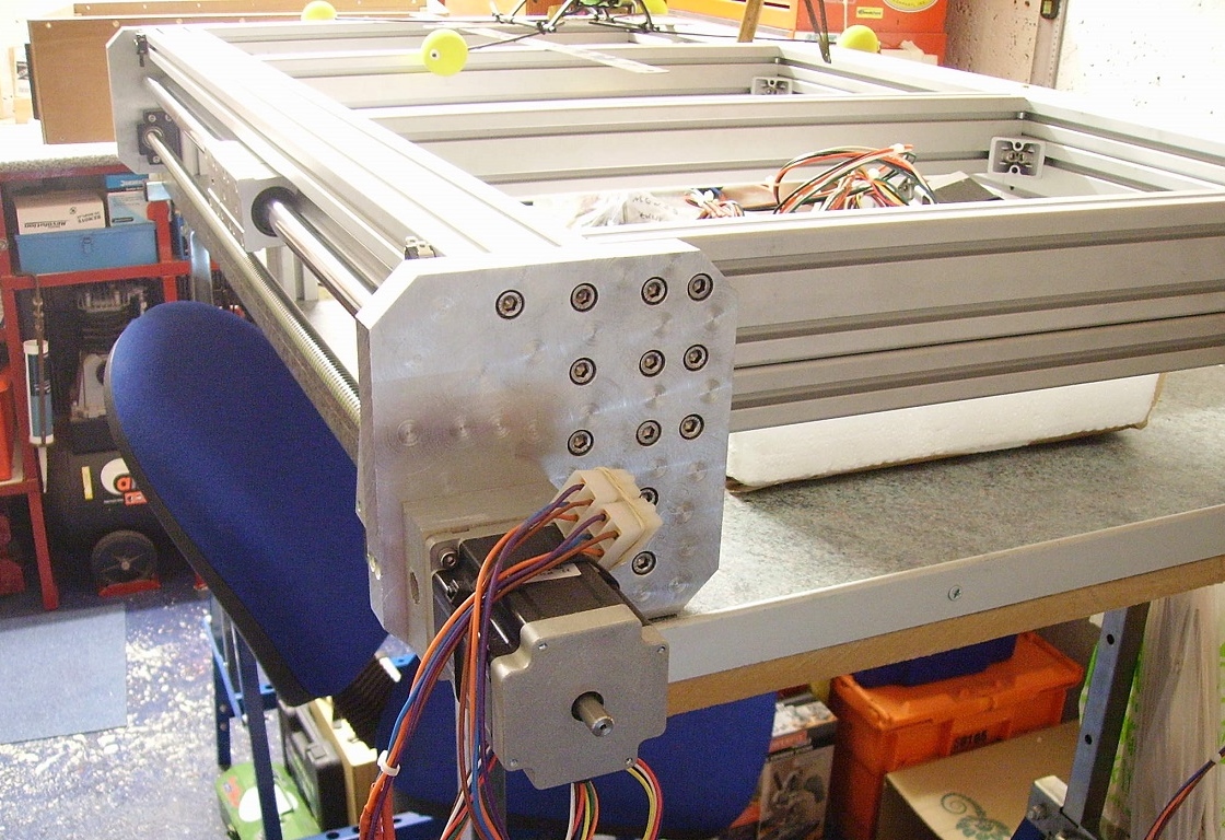

    Another picture got finished counter boring the X axiz end plates with a bit of luck I will get them bolted on to the frame today.

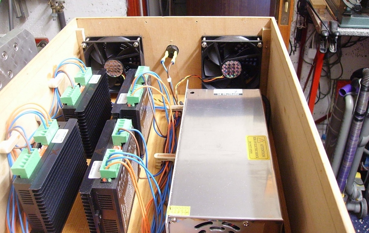

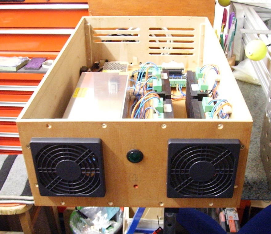

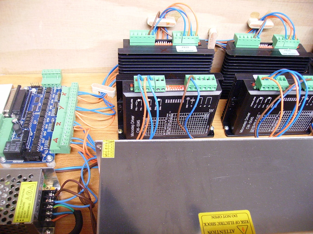

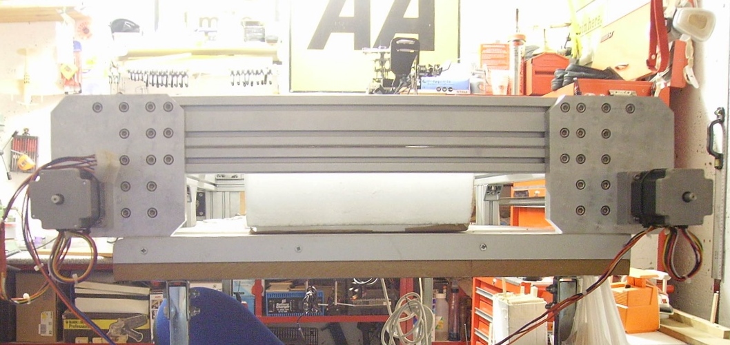

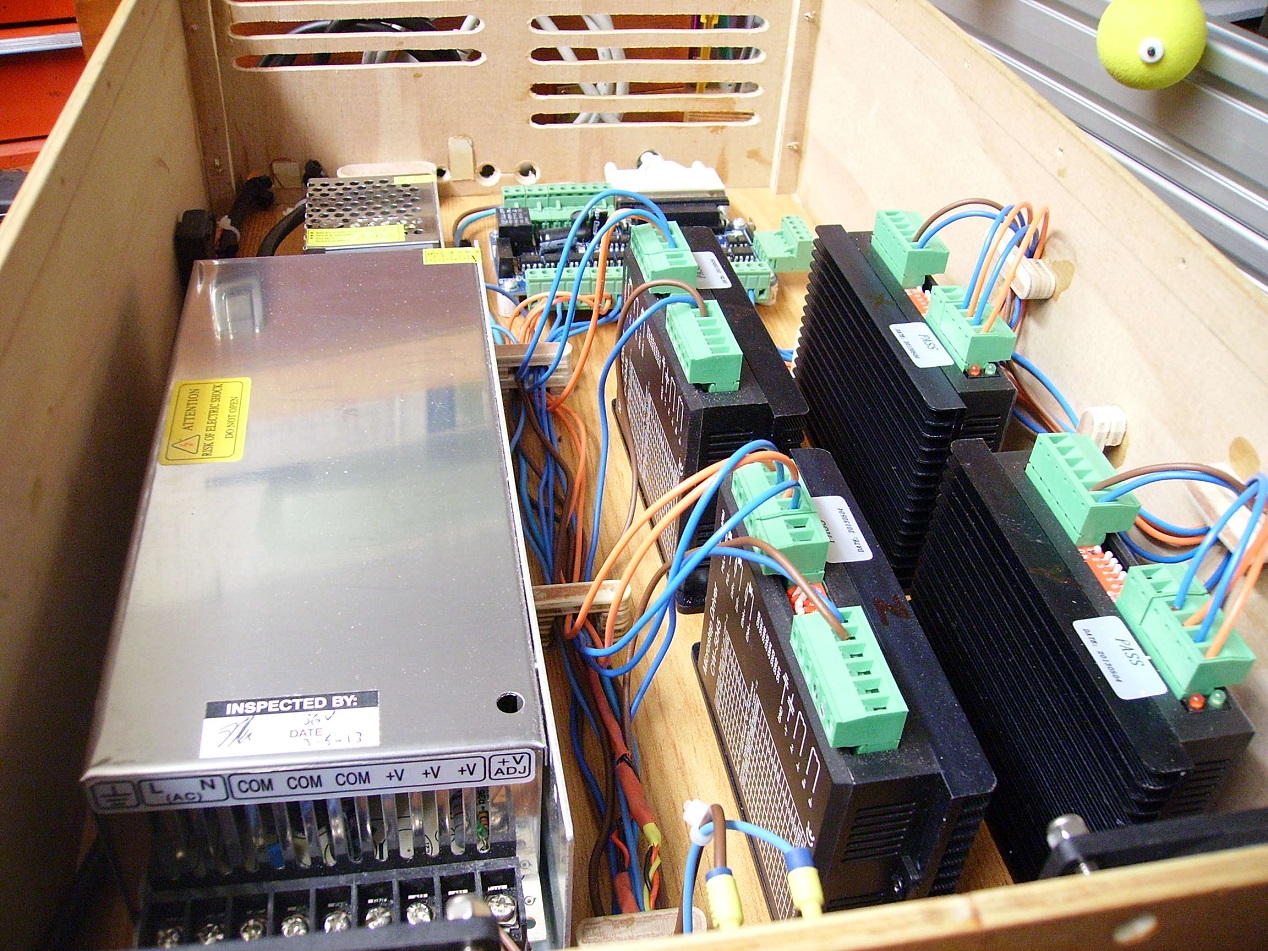

    Been a while since I did any work to my CNC router as I was in Hospital again for a few days and the wife has band me from the garage. But I did get some wiring done, but have a lot more to do, I'm waiting on a E stop switch and more wire.
    So just some photo's where I stand at this time. I hope to get going again in the next couple of weeks.
