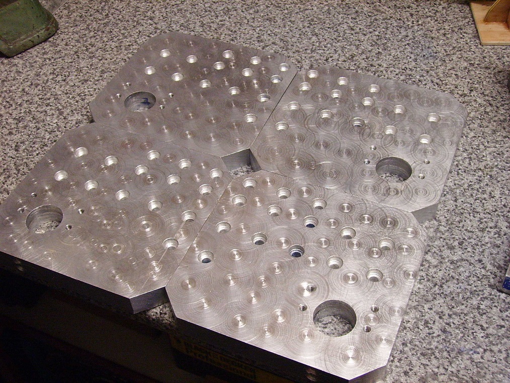

    Another picture got finished counter boring the X axiz end plates with a bit of luck I will get them bolted on to the frame today.

    Bit late now but a chop saw would have been a good investment for you if you have problems using a hacksaw.
    With the right blade you could have cut all the aluminium both plate & profile yourself which would have made things a bit easier, plus it would also be handy for cutting aluminium to size before machining it once the router is up & running.
    Yes I though about buy a chop saw. But it would take money away from my CNC budget. I don't mind taking three days to cut a part of aluminium as I can only work for short periods anyway.
