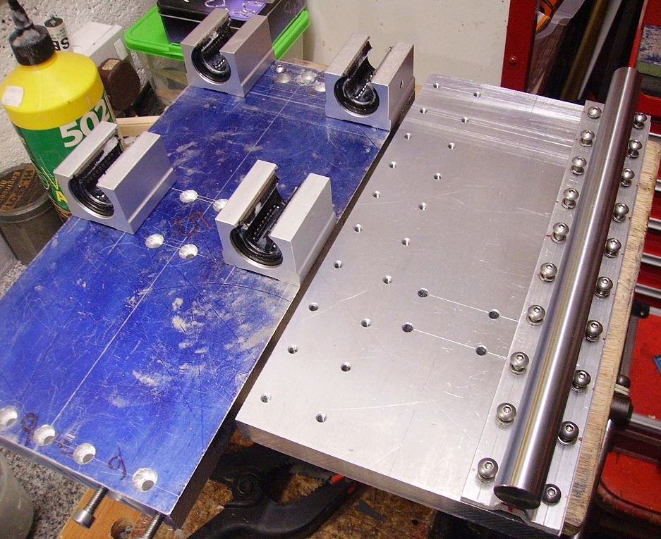

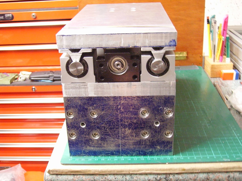

    Right, I have made one small change to the Y axis to tie it all together. So no more changed till it is built. I ordered some 6082 aluminium plate and have started to construct the Z axis.
    I can only do a little at a time before the pain is to severe and I have to stop, It will be a slow build but I will get there. Anyway one drawing of the change and two pictures to keep you going.

    looks like some good progress Mike. that back plate will help stiffen it all up.
    glad all the comments didn't put you off. keep it up

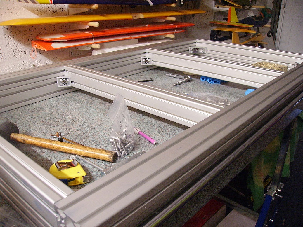

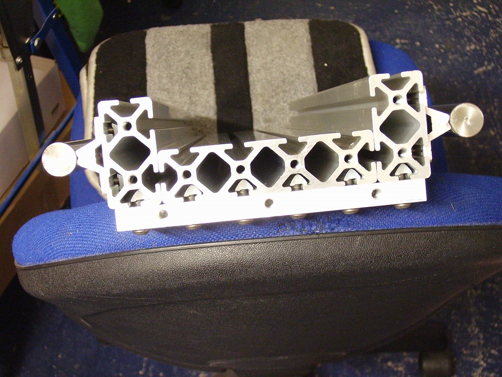

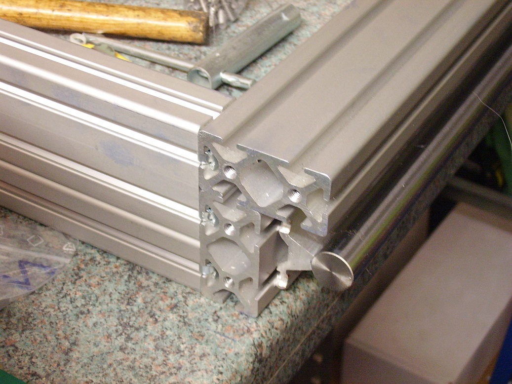

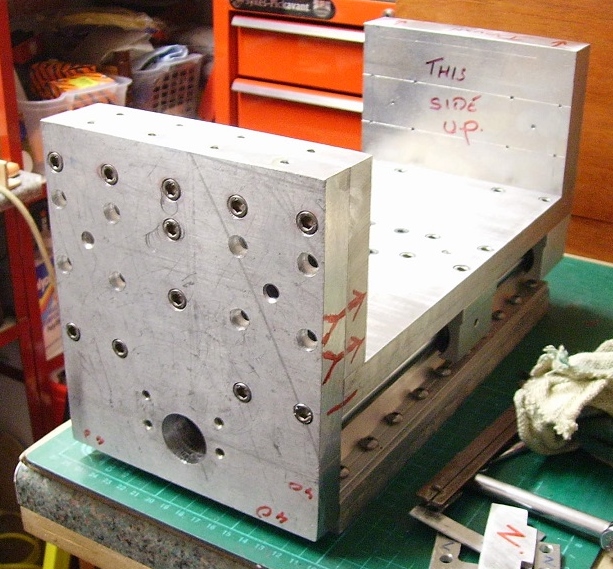

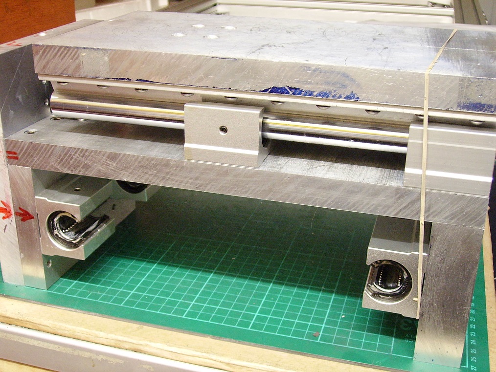

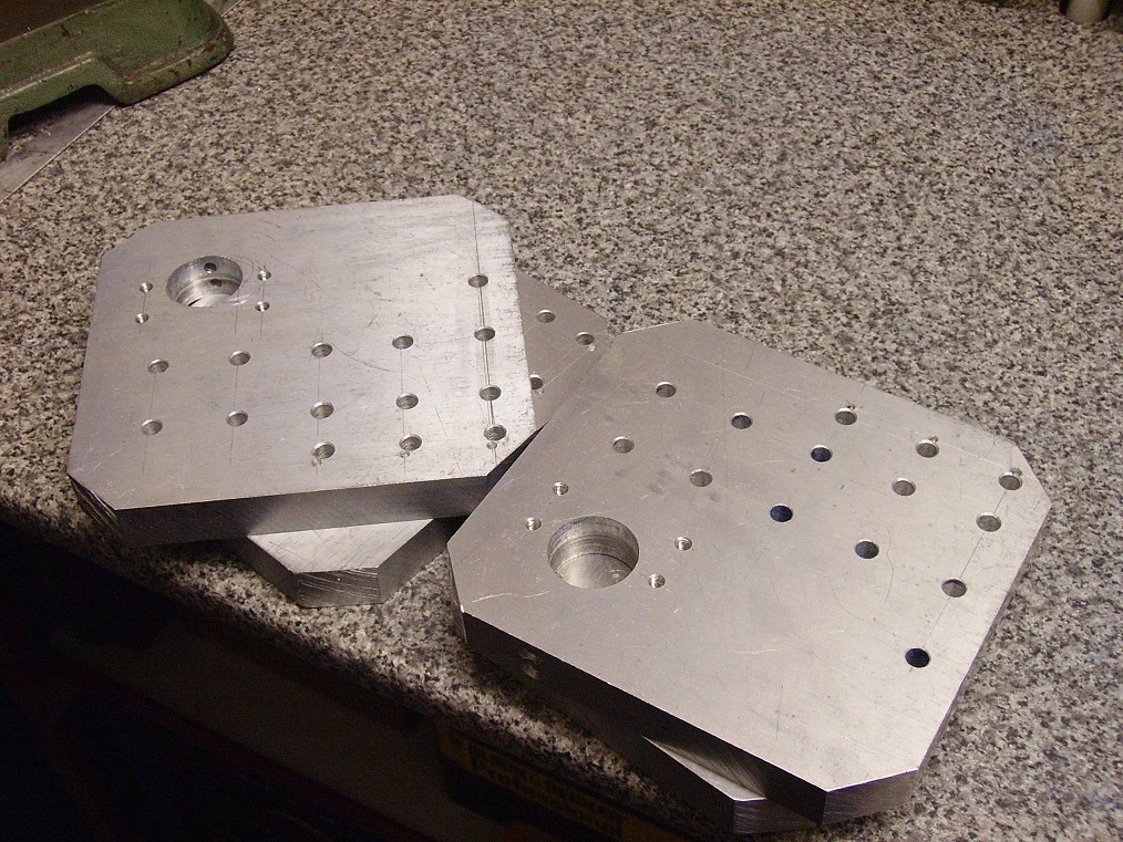

    Ok here is another part done I had to cut 3mm off the aluminium plate, as they came to large. Now the only way I could cut the 3mm off was with a hand held router and a M6 end mill with the plate held in a wooden jig. That was hard going. Anyway with stops to rest I did start to assemble the bed.
ID:	8975Click image for larger version.
ID:	8976Click image for larger version.
ID:	8977Click image for larger version.
ID:	8978Click image for larger version.
ID:	8979Click image for larger version.
