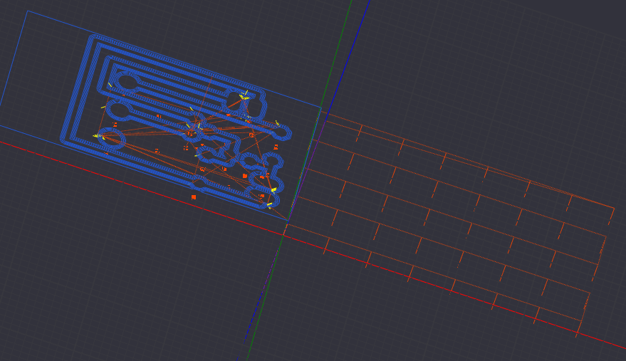

    OK so I have done a bit of testing and fixing.
    First of all I opened the levelled file in cambam. This is what I got:
    The red lines are the probing routine. The probe points need to cover the design for levelling to take place. So, in the image, the design is on the negative side of X, whereas the probes are on the positive side. The probe values should be something like:
    X = -37
    Y = 0
    X length = 37
    Y length = 20
    Then the probes should cover the design. As I said, this is done automatically in the new version so you dont need to worry about the probe settings.
    However... This will not fix the divide by zero error because version 0.5 seems to struggle with negative coordinates. I have generated and attached the levelled file generated with version 0.7 (not yet released) if you want to try it.
    best,

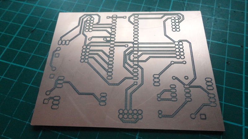

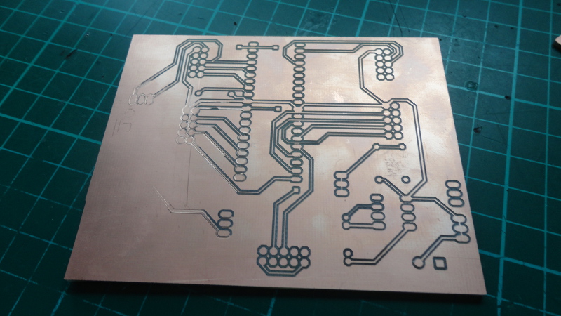

    To demonstrate this problem, here is a pic of a non-autoleveled circuit board:
    Attachment 8750
    There is a huge area in the bottom left which is completely missing. This is with a leveled table so only the board flex is an issue here.
    This is the exact same 100x80mm circuit with my autoleveling software in operation (same pcb-gcode settings, same method of fixing the board down etc.):
    Attachment 8751
    As you can see, this is much more consistent. The traces are thin but thats due to the settings in pcb-gcode and Eagle, not the autoleveler.
