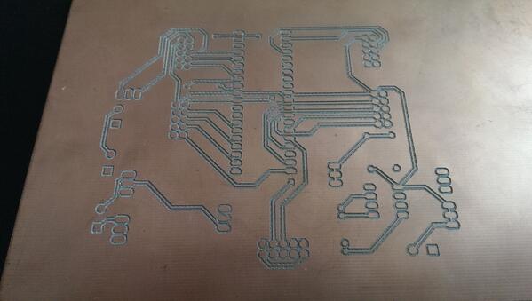

    Sorry I haven't been on here for a while, been a tad busy of late.
    The latest version of AutoLeveller is 0.8.2 and as of 0.8 you can log your probe points to a file then feed that log file back into AutoLeveller to perform calculations within the software itself rather than in the GCode file. This means you only have to do a full probe one time and if your tool bit breaks for example you can just replace the tool, reset your Z and resume etching where you left off.
    Here is an image of a board made using this technique with 0.8...
    0.8.2 fully supports LinuxCNC, Mach3 and TurboCNC
    You will need to log-in or register to access the latest pre-compiled binary files (.exe and .jar), alternatively download the source code for free or try the free version (up to 0.7.7).
    I am happy to answer any questions you have. Enjoy
