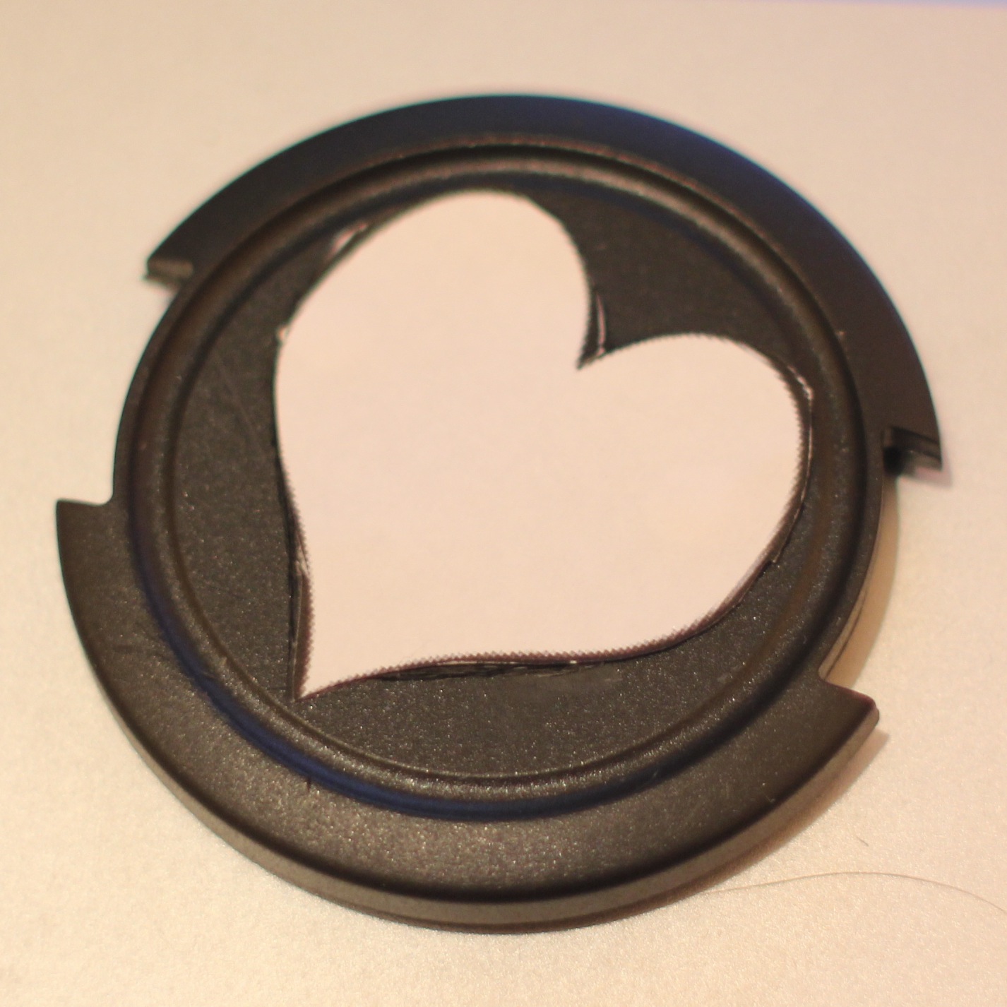

    I have some lens caps here and I'd like some simple shapes cut into them, I was wondering if you could help me out.
    The caps are overall 6x6cm and the area on them for cutting is a mere 5x5cm. The thickness is about 2-3mm thick.
    I've attached a picture of the sort of thing I want. So it would be a complete cut out. I can file it smooth on my end, I just need it cutting.
    Other shapes I have is a star, christmas tree and flower.

    The designs need to be centred exactly in the middle of the inner circle on the lens cap.

    Clamping something like that to a mill bed/vice would be a PITA. Personally, I think you'd be better off drilling/filing/sanding the shapes. Depending on the type of plastic, you might get decent results cutting it with a hot wire.
    Dont know if it could be cut by laser without issues with the plastic? Not that I have a laser machine anyway but it might get around the clamping issue. This is the kind of thing I had in mind: Lasersaur by Nortd Labs

    Easy enough to make a little jig.
    Doddle to do on a laser but depends on material, lasers can't do PVC
    If you want to send me a sample cap and artwork I'd willingly bung one on the laser.

    Hi. if John has no luck with the laser I am sure I can make A jig and do it on the router (0.5mm cutter), but like John would need a sample and art work,

    OK sent an email but it all depends on the material. If it's hard plastic then it's probably OK, soft piable plastic may make it PVC which is a no no as it gives off poison gas and hydrochloric acid.
    Simple heart shape like shown will take about 10 seconds to cut as being non contact it's very quick.
