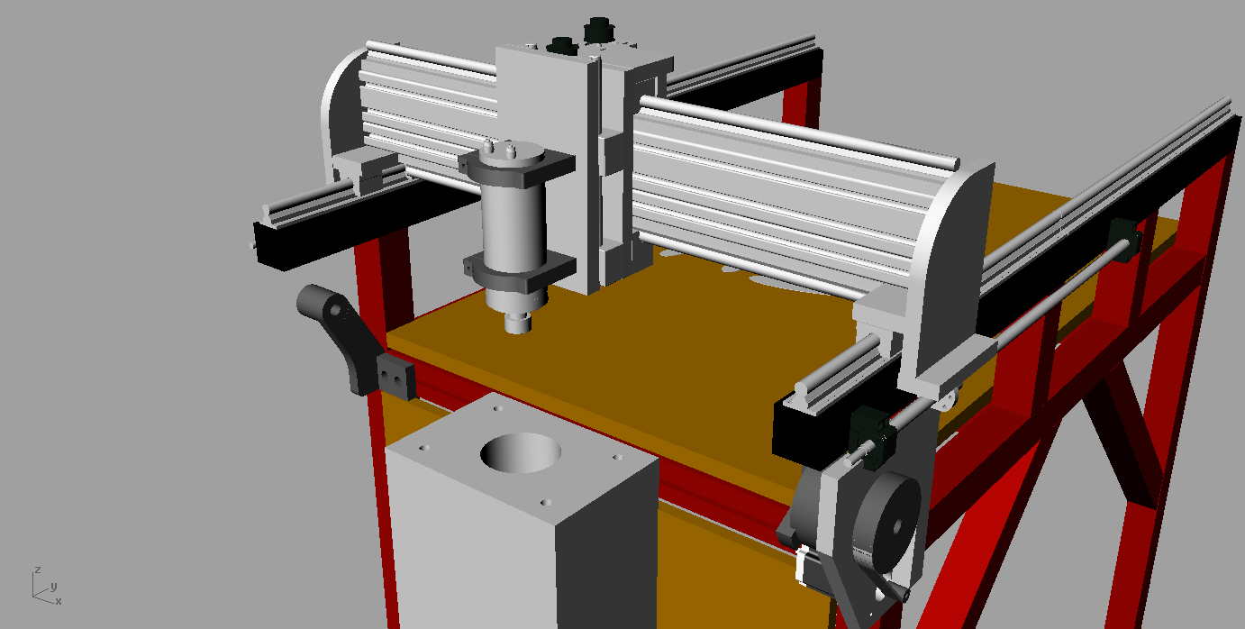

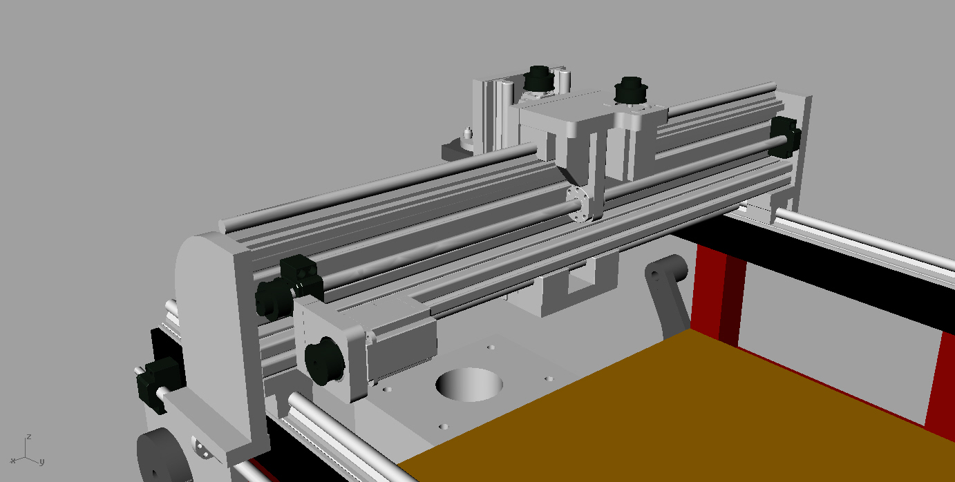

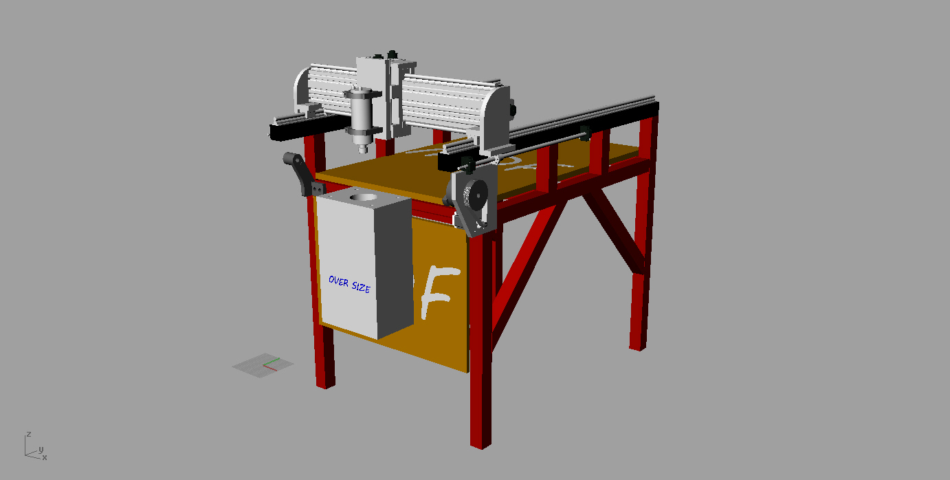

    To add to this regards design then try to avoid high gantry sides. My preferred way is not to have any gantry so to speak and mount the Gantry direct onto the rail bearings. This means designing the frame so it raises the rail mounting surfaces but unfortunately it mostly suits using Twin ball-screws on the long X axis. It could be made to use a single centre driven ball-screw but just not has clean a design and weaker.
    This twin screw design is very very strong and ridge which helps eliminate Twist, resonance and flex which is the enemy and gives poor finish etc.!! DONT under estimate the forces required when cutting, Even wood.!! Weak gantry and Z axis will result in poor cut finish.
    (Will attach render of wood cutting design to give an idea of what I mean regards gantry on rails)
