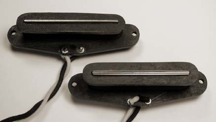

    It's now looking like I'll need to source some of these in number, not even sure what it would be called (presently I refer to it as 'a small bit of rectangular 1.6mm thick steel'! - not that catchy - would there be a more appropriate name as used int he industry?)...
    If I know how it would be made, then I know who to approach.
    Spec is ....1.6mm thick mild steel, about 33mm(ish) x 4mm (I'll also need some about 20mm x 4mm)
    From what I can gather....laser cutting is out (deformation?), water jet cutting is a possibility but would probably need tabs...else the part falls into the water tank below! (which means a bit of a hassle tarting up the de-tabbed part) ....could something like this be stamped/pressed out of 1.6mm sheet? (sorry if this is a naive question....but this is all a brave new world to me!)
    Ideas on the back of a postcard please!

    It's a 'blade' for the inside (pole piece) of a guitar blade pickup, I found this on google images to give you an idea....
    But these will be very low profile....& I really need the accuracy that I'd not be able to attain with a jigsaw (each long thin edge needs to be nice & flat...the top visible edge must look good, the bottom nice & flat so the magnets attach well) ...also, I'm not talking a few - probably at least one thousand pcs initially (& that'll get old very quick with 'me and a jigsaw!)!)
    33mm long? where did the other 2 strings go?
    Good spot...perhaps I could sell to banjoists or maybe back to the drawing board ;-)
    Joking apart, that's just the blade for EADG...there's a small gap of 1mm & then B & E get their own blade/treatment (I didn't want to cloud the issue, hence only showing the EADG blade!)
