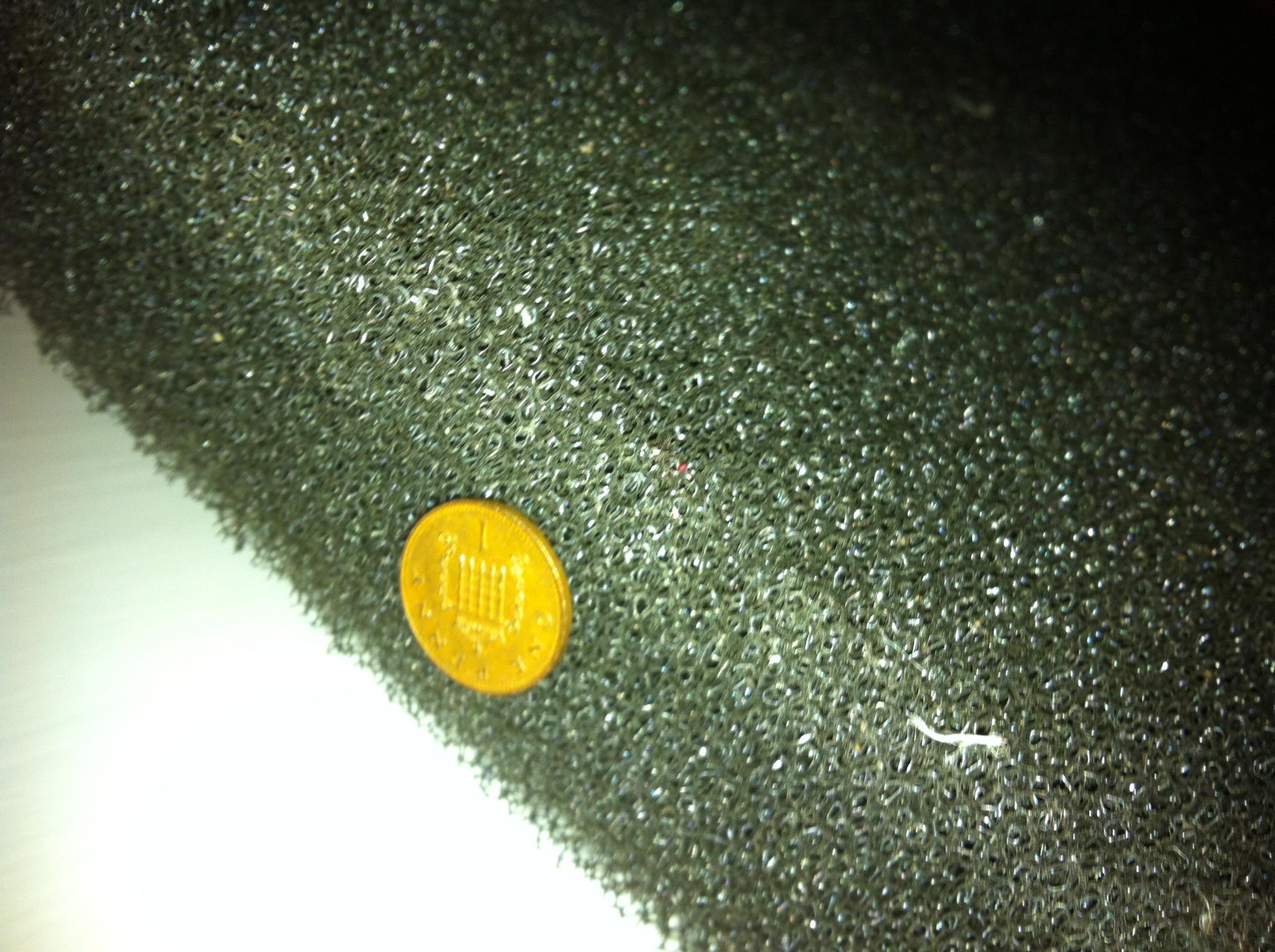

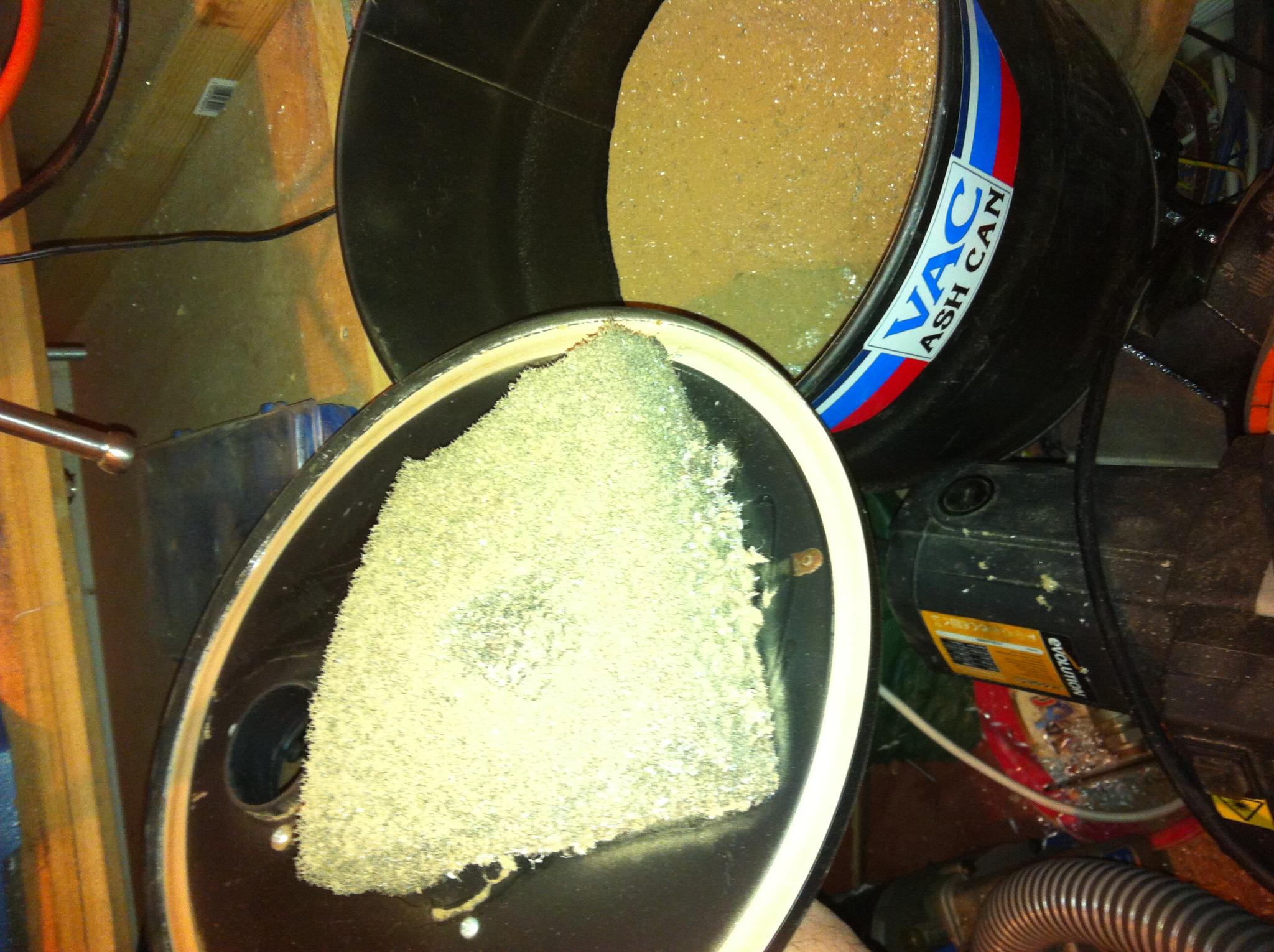

    iv been using an ash can from machine mart for about 8 months
    i removed the mesh dome from inside and stuck a peice of HVAC filter medium over the vacuum inlet hole to filter the fine particals its been working fine and the cheap tesco vacuum rarely needs cleaning out.
ID:	8921Click image for larger version.
    iv got a few peices of filter medium going spare if anyone wants one just PM me.
