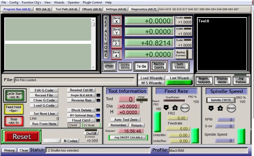

    A tutorial to show the configuration of Mach3 (with standard screens) to find the center of a hole or pipe.
    the code is IN MILLIMETERS if you wish to use Imperial measurements you will have to edit the code accordingly.
    You must get this right or you could damage your machine or probe or worse!!
    I was not able to find a tutorial that started at the beginning for the novice, so why not have one here.
    This tutorial assumes you have fitted a probe on your system, and assigned it to an input, and that the large digitise led on the diagnostics tab in Mach3 lights when you activate it.
    Some of the buttons in Mach3, although shown on the screens do not do anything when pressed, this is because they have no code or script assigned to them.(Great idea that)
    In the few steps to follow, we will assign some code to a button for center finding, this procedure can be used with other buttons as well, as long as you can find the code for the button you wish to assign it too. The script/code we will be using is not mine, it has several authors as it has evolved over time and I’m sure it will evolve further in the future.
    Ok first things first.
    There may be a better way to do this but as nobody seems to have done it as a tutorial I’m having a go. if you have a better way then submit it as a tutorial of your own and by all means pop a link to it in this thread, after all the more views the better, but let’s not make this any more complicated than it needs to be. If you have clever dick comments then keep them to yourself as this is not a debate, or pm me :)
    Of course if you have constructive comments then please don’t be shy and at the end of this we should have a nice little tutorial for the site.. (That’s why we are members isn’t it)

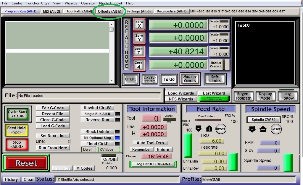

    The Main screen in Mach3

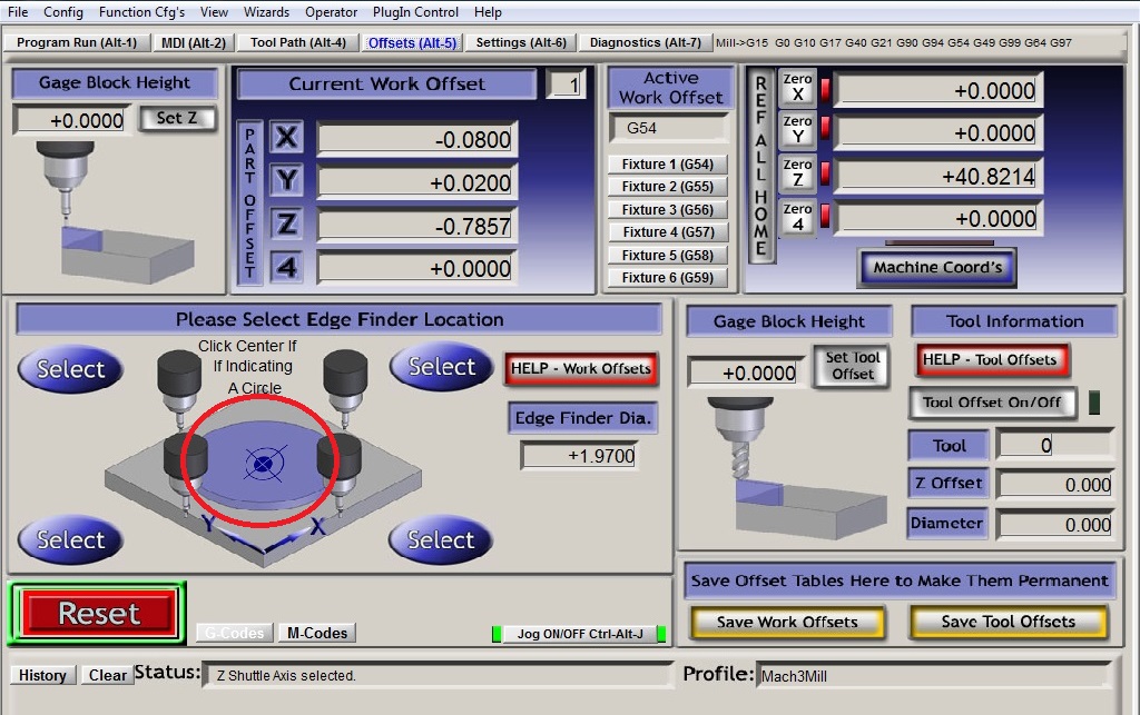

    Select the Offsets Tab indicated

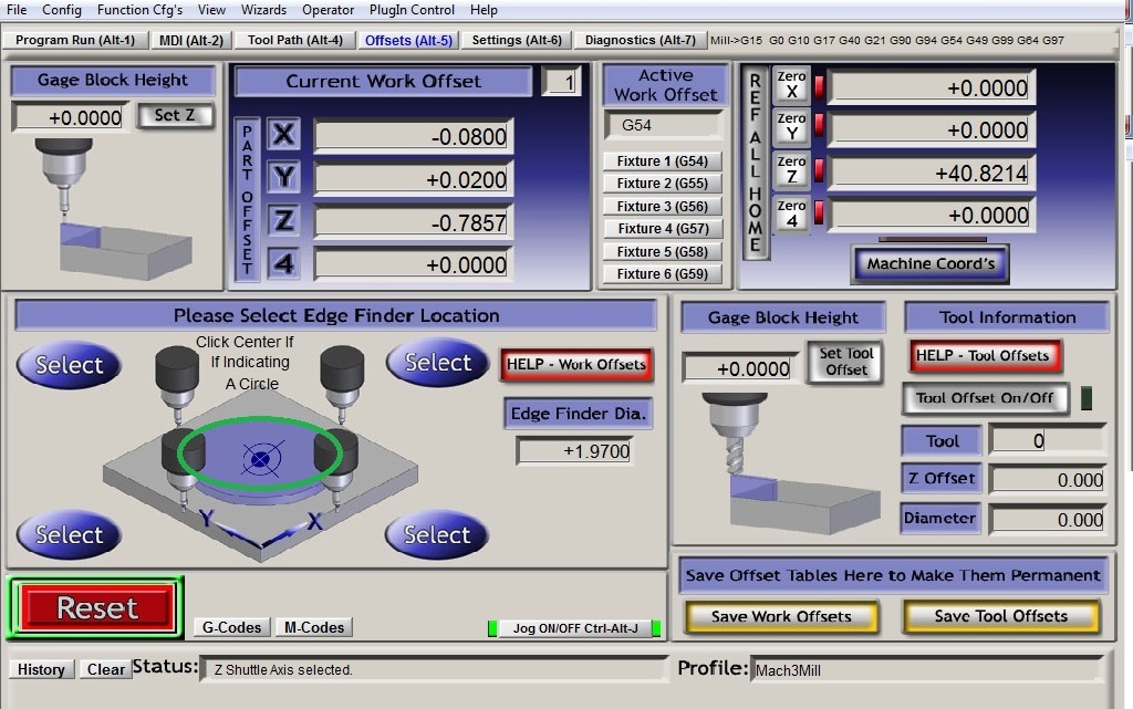

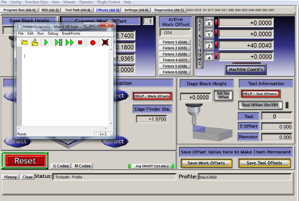

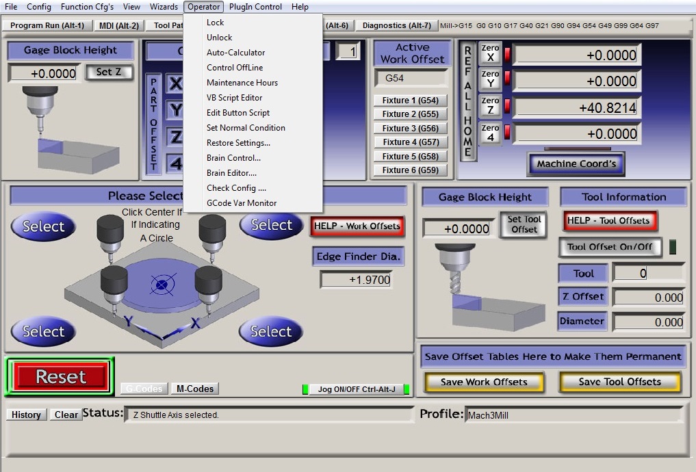

    This screen has a number of functions that can be performed using a probe/edge finder this tutorial will be using a touch probe, select the operator button in the file menu bar indicated below.

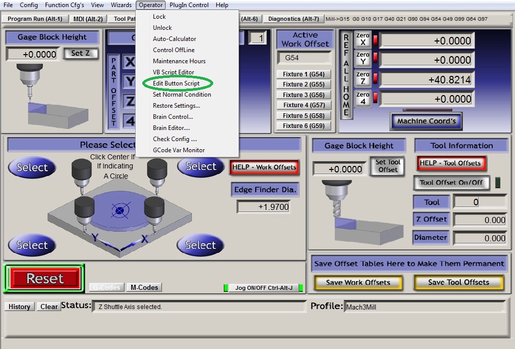

    As we are assigning a function to a button select button script from the dropdown menu

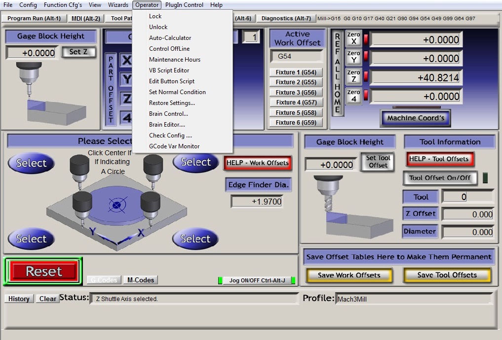

    This will cause all the buttons that can be assigned to flash, select the centering button indicated below.

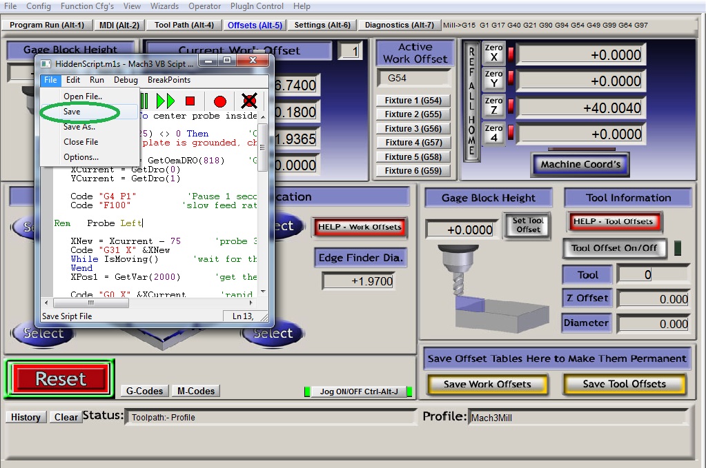

    A code box for the selected button will appear, Copy the code at the bottom of the post into this box.
    And don’t forget to save it as indicated in the picture
    And that’s it!!
    Assuming the probe is fitted and working, using jog, move the probe down (5mm or more will do) into the hole or pipe you wish to have the machine centered to. And hit the Red circled button..
    The Code
    Rem VBScript To center probe inside a pipe
    If GetOemLed (825) <> 0 Then 'Check to see if the probe is already grounded or faulty
    Code "(Probe plate is grounded, check connection and try again)"
    Else
    FeedCurrent = GetOemDRO(818) 'Get the current settings
    XCurrent = GetDro(0)
    YCurrent = GetDro(1)
    Code "G4 P1" 'Pause 1 second to give time to position probe plate
    Code "F100" 'slow feed rate to 4 ipm 100mm
    Rem Probe Left
    XNew = Xcurrent - 75 'probe 3 inches to left 75mm
    Code "G31 X" &XNew
    While IsMoving() 'wait for the move to finish
    Wend
    XPos1 = GetVar(2000) 'get the probe touch location
    Code "G0 X" &XCurrent 'rapid move back to start point
    Rem Probe Right
    XNew = XCurrent + 75 'probe 3 inches to right 75mm
    Code "G31 X" &XNew
    While IsMoving()
    Wend
    XPos2 = GetVar(2000)
    XCenter = (XPos1 + XPos2) / 2 'center is midway between XPos1 and XPos2
    Code "G0 X" &XCenter 'rapid move to the x center location
    Rem Probe up
    YNew = YCurrent + 75
    Code "G31 Y" &YNew
    While IsMoving()
    Wend
    YPos1 = GetVar(2001)
    Code "G0 Y" &YCurrent
    Rem Probe down
    YNew = YCurrent - 75
    Code "G31 Y" &YNew
    While IsMoving()
    Wend
    YPos2 = GetVar(2001)
    YCenter = (YPos1 + YPos2) / 2
    Rem move To the center
    Code "G0 Y" &YCenter
    While IsMoving ()
    Wend
    Code "F" &FeedCurrent 'restore starting feed rate
    DoOEMButton ( 1008 )
    DoOEMButton ( 1009 )
    End If
    The Code
    Just copy this code into the box when prompted this version will zero the X,Y when Finished.
    I always run it twice
    this tutorial works on my machine...but use it at your own risk!!
