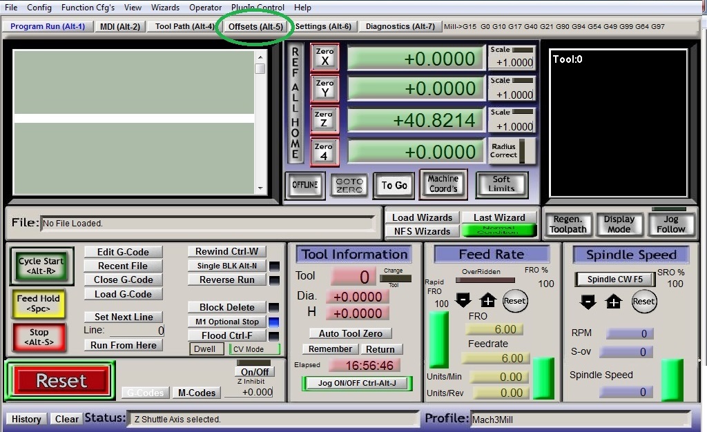

    The Main screen in Mach3
    Select the Offsets Tab indicated

    Assuming the probe is fitted and working, using jog, move the probe down (5mm or more will do) into the hole or pipe you wish to have the machine centered to. And hit the Red circled button..
