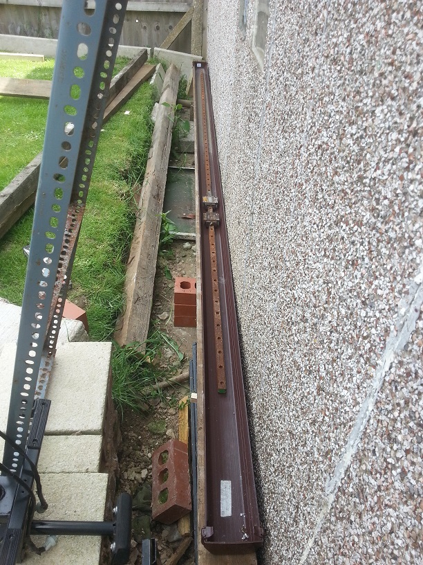

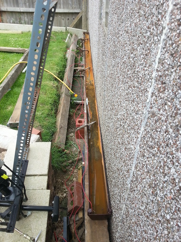

    bog standard soda from tesco or where ever is what i use. for the long stuff use long rods for electrodes each side rather than short ones at the end as wel
    Electrolysis? Doesn't that need some high current power supplies and the right material for the anode and cathode? I'm not sure what cola has to do with it? Confused here!
  4. #14
    Cola? Soda crystals wally :-)
    A car charger and steel will do, just need to clean them off once in a while.

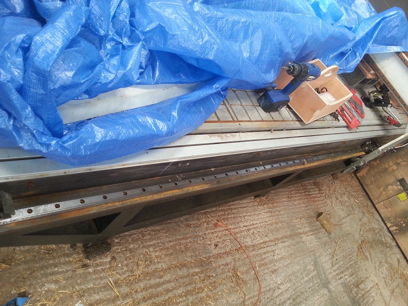

    so, last week I done some experimental electrolysis with small tanks to establish best results.
    I stopeed off at the farm on way home from work friday and removed a rail.
    Stole a bit of gutter off one of my sheds to create a long tank...

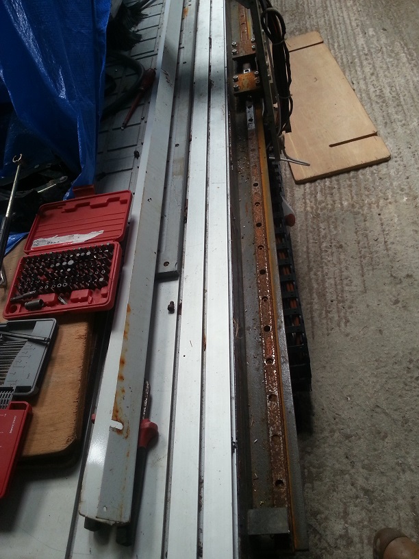

    abra kadabra

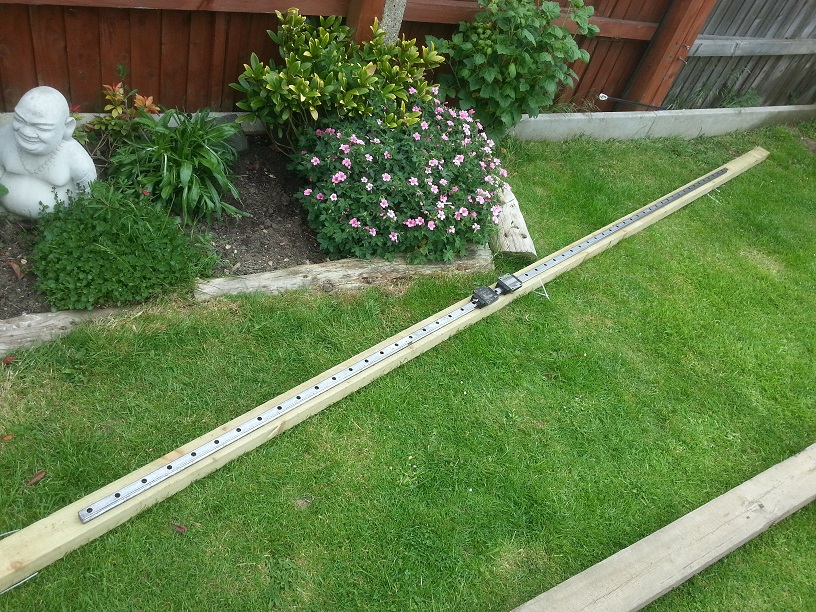

    after 24 hours...
    bearings slide lovely, no play
    all back on machine, heavily greased (after this pic)
