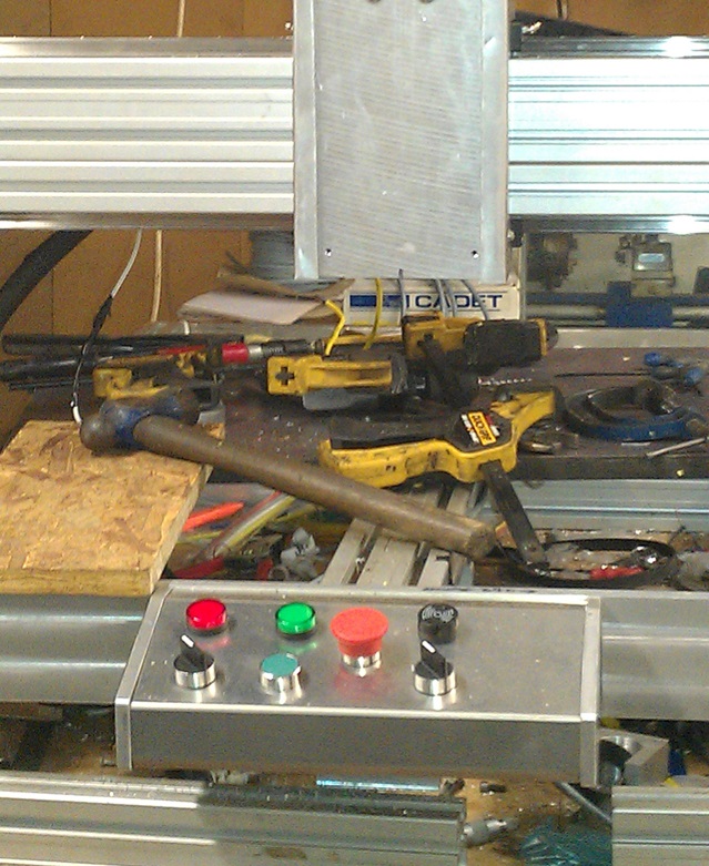

    These are what I use on machine. . . Left to right.
    Control power ON/OFF 240Vac switch and Led light.
    Momentary Start/Reset button with 24Vdc Led
    OH SHITE BUTTON
    Limit over ride switch with 24Vdc Buzzer.
    Also on the Main box there's a master power contactor switch which controls main power to everything, VFD, vaccum etc.
