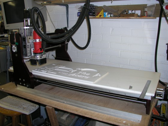

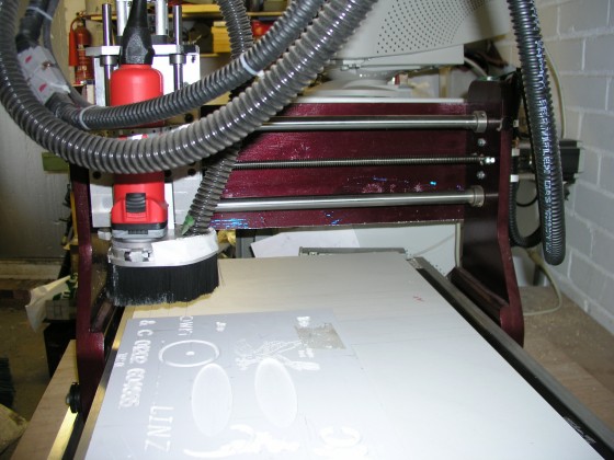

    zim's Avatar
    Location unknown. Last Activity: 12-07-2012 Has been a member for 9-10 years. Has a total post count of 8.
    Hopefully here's some pics.
    zim.
