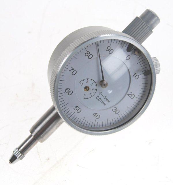

  4. there are however two types, a plunger type e.g.

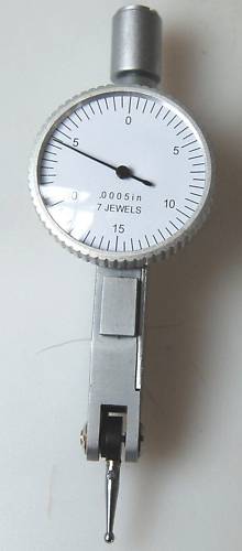

    and a lever type e.g.
    Each has pros and cons. Generally I find the lever type more useful [discuss]
