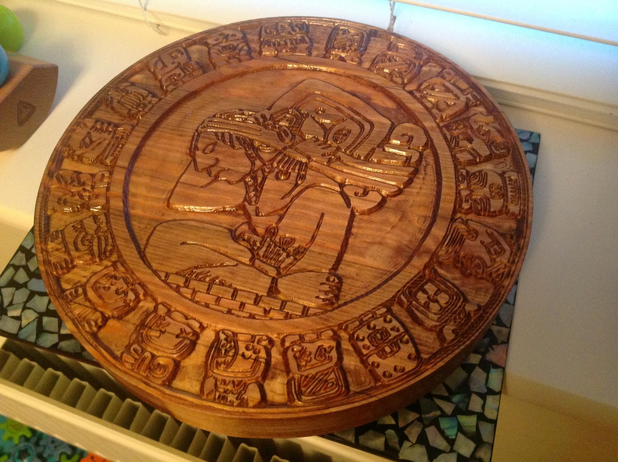

    Ok here is my first go at something since my shocking egg shape circle test cuts and I have to say I am proper chuffed with it!
    I have seen the aztec sun stones many of you guys have which look great but thought it may be a bit ambitious for my first go so i decided on a maya calendar design which looks far simpler!
    I don't have any nice wood but I had an old piece of timber in the garage (pine I think) so I cut into 3 bits, surfaced the sides on the cnc, glued them together and then cut the calendar design.
    A little bit of tweaking after the cut to tidy up and happy days!

    I know there is lots of room to improve so if you guys spot anything and have advice I would be happy to hear it.

    What was the total run time for the job, cutter used and the size of the part?
    .Me
    Thanks Lee!
    Finished size is 260mm diameter and 35mm thick.
    90deg 9.5mm v bit - 40 mins (it was quicker but I had to slow the feeds right down as I have a bit of flex in my machine and slowing it down seemed to compensate well enough)
    3 mm end mill to tack the flats down 2 mm - about 10 mins
    6mm end mill for the profile cut out - 4 mins
    Jim

    How much sanding was involved? did it frey on the detail? Ive looked through your previous posts no photos of your machine? lets have a look....

    I used a brand new v bit and there was hardly any clean up on the detail to do after. Just a couple of sections needed a scrape with a blade. Unfortunately the flat areas was a different matter..... Very bad fraying around every edge! I do wonder if it would have been better to do the flat spots first followed by the v carving? I imagine the v bit would have cleaned it up quite a bit?
    Also the flat areas really showed up the alignment issues I have the z axis. It left lots of lines on every flat area, which needed a bit of sanding. I have been looking into getting a dial test indicator to measure and sort the alignment but I also think I have an issue with flex on the gantry....the z is fixed to the gantry by two (thin) unsupported rails....yeah I know, the unsupported rails are not great and I think one of my next posts will be to ask advice on how I might approach changing them. I will strike some pics of the machine up then for everyone to have a laugh at!

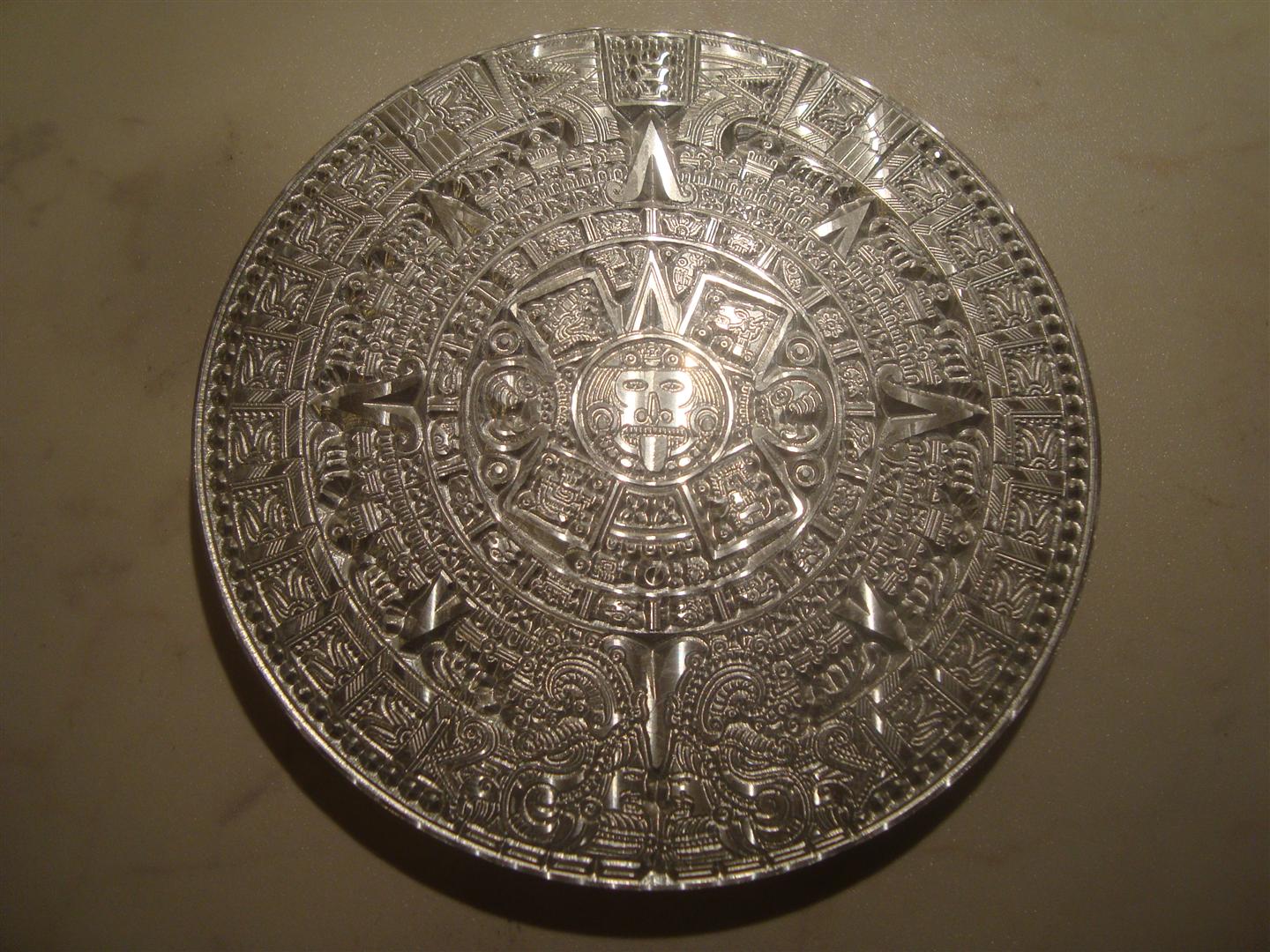

    That looks good. There's a more ambitious one here if you want to try it. This is the one I cut, aluminium naturally:

    Quote Originally Posted by cncJim View Post
    90deg 9.5mm v bit - 40 mins (it was quicker but I had to slow the feeds right down as I have a bit of flex in my machine and slowing it down to compensate well enough)
    When the machine isn't sufficiently rigid it's better to lower the depth of cut and keep the feedrate at the correct value. The reason for this is clearly you need to lower the force on the cutter, which lowering the depth of cut will of course do, but you don't want to lower the feedrate as that lowers the chipload (assuming constant spindle speed), as that will cause more wear on the cutter and more heat.
